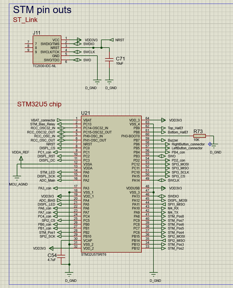

I've added the schematic diagram for the ST link to my chip for reference.

The 10µF capacitor (C71) on the SWD lines might be causing issues, try reducing the capacitance or removing it temporarily to see if the issue persists?

Then you'll need to review the connector, and what it connects too. Make sure you've not mirrored or confused the pin designations.
This isn't a standard 10/20-pin JTAG as exported by the ST-LINK's
Review your netlist. Review all pin assignments.
Review part orientation.
Check analogue supply.
Check voltage on VCAP pin

PC13 probably isn't suitable for driving things, it's typically in a low-power domain

10 uF cap on NRST is way too high. Should be 0.1 uF. I'm not sure if this will cause issues. Is VDD decoupled? Is VDDA connected to VDD? Lots of details we can't see in the portion of the schematic you sent. Consistent issues with chips shorting suggest a protection diode is getting blown. Is VDD stable? Generated from an LDO?

Thank you very much for your responses, @Tesla DeLorean I've checked the pin out on the JTAG connector and it matches the pins on the JTAG schematic so I don't suspect its that. With regards to the PC13, that a GPIO logic input of 3V to 0V, so nothing is being driven from it.

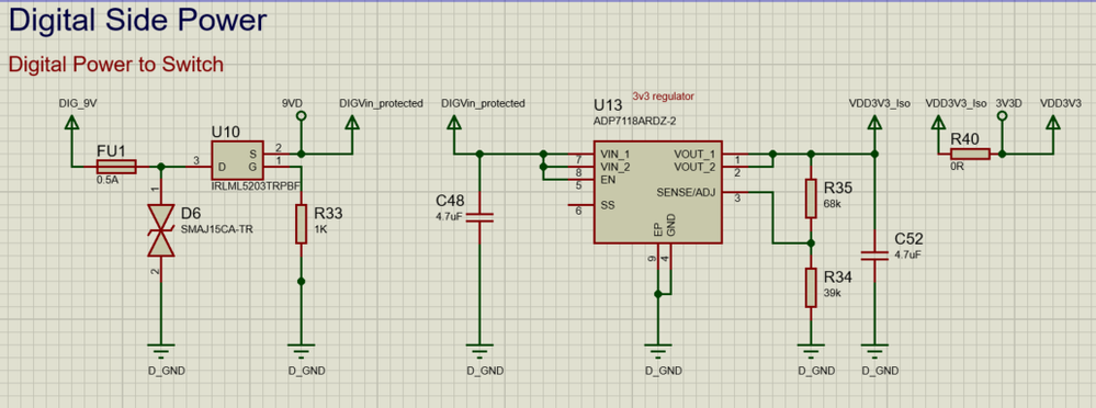

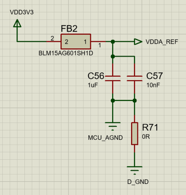

The power supply is a stable 9V, which is protected and then passed through a LDO to drop it to 3V3, I've attached the schematic for the protections and LDO implementation, and I have attached the schematic for the VDD and VDDA isolation @TDK. There may be an issue there, but I have followed the recommended layout from the data sheet.
I will try and reduce the cap on NRST to 0.1uF and see what effect that has.

To update this post, I have bought a new tag-connect cable and changed the cap C71 to be a 0.1uF to program and the U575 chip has programmed without fault. I've also hooked it up to a scope when programming and didn't see any strange behaviour. If this happens again I will update this post, but all seems well at this point in time. Thanks for your guys help on this.
