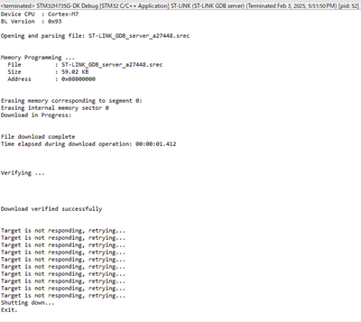

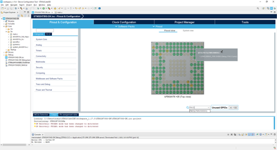

In STM32CubeIDE 1.13.0, I make project for the board and debug ( Fig.1 ).
I haven't added anything to the created files, but debugging failed ( Fig.2 ).

I thought it might be a deadlock state, so I tried to recover from the deadlock using the STM32CubeProgrammer method as described in the documentation ( https://www.st.com/resource/en/user_manual/um2679-discovery-kit-with-stm32h735ig-mcu-stmicroelectronics.pdf 6.2.4).
When I debug after running the method, I get Figure 3 in the debug console. If I debug again I get back to Figure 2.

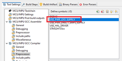

Most probably the behavior is related to an already raised issue in CubeMx in this thread.
Go to the preprocessor in your IDE and remove the USE_PWR_LDO_SUPPLY definition:

2025-02-03 2:19 AM - edited 2025-02-03 2:19 AM
