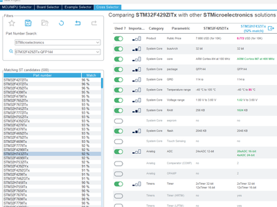

Hello @mckim0306 ,
I recommend you check and compare different part numbers and their characteristics using "Cross selector" feature within STM32CubeMX:
