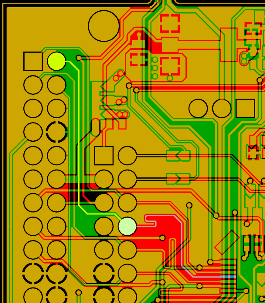

I had a look at the GERBER data of the NUCLEO-L552ZE-Q and found:
No other component, jumper or any other connection is visible there.
Are you 100% sure that you are measuring the short circuit between CK (CN8.10 or CN11.3) and D3 (CN8.8 or CN11.2)?
Regards
/Peter
2026-05-27 2:38 AM
I quickly inserted the net, i.e. the tracks on PC11, as a screenshot:
It is easy to see here that only CN8.8 and CN11.2 are actually on the track. The other layers have only cut-outs there and no connection at all:
