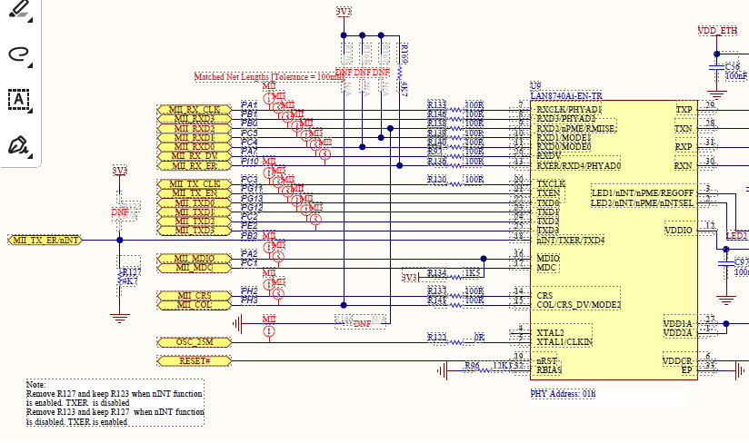

If the PHY is the LAN8742A as on most ST boards, it's surely an RMII interface.
2026-03-05 10:35 AM
Looking at the board schematics, it indicates MII mode:
MII Signal STM32 Pin Status
| ETH_TX_CLK | PC3 | ✓ Configured |
| ETH_TX_EN | PG11 | ✓ Configured |
| ETH_TXD0 | PG13 | ✓ Configured |
| ETH_TXD1 | PG12 | ✓ Configured |
| ETH_TXD2 | PC2 | ✓ Configured |
| ETH_TXD3 | PE2 | ✓ Configured |
| ETH_RX_CLK | PA1 | ✓ Configured |
| ETH_RX_DV | PA7 | ✓ Configured |
| ETH_RXD0 | PC4 | ✓ Configured |
| ETH_RXD1 | PC5 | ✓ Configured |
| ETH_RXD2 | PB0 | ✓ Configured |
| ETH_RXD3 | PB1 | ✓ Configured |
| ETH_CRS | PA0 | ✓ Configured |
| ETH_COL | PA3 | ✓ Configured |
| ETH_MDC | PC1 | ✓ Configured |
| ETH_MDIO | PA2 | ✓ Configured |
| ETH_RX_ER | PI10 | ✓ Configured |

huart3.Init.OverSampling = UART_OVERSAMPLING_16;
if (HAL_UART_Init(&huart3) != HAL_OK)
Error_Handler();
* @PAram None
* @retval None
/* GPIO Ports Clock Enable */
__HAL_RCC_GPIOI_CLK_ENABLE();
__HAL_RCC_GPIOB_CLK_ENABLE();
__HAL_RCC_GPIOK_CLK_ENABLE();
__HAL_RCC_GPIOG_CLK_ENABLE();
__HAL_RCC_GPIOC_CLK_ENABLE();
__HAL_RCC_GPIOE_CLK_ENABLE();
__HAL_RCC_GPIOJ_CLK_ENABLE();
__HAL_RCC_GPIOD_CLK_ENABLE();
__HAL_RCC_GPIOH_CLK_ENABLE();
__HAL_RCC_GPIOA_CLK_ENABLE();
__HAL_RCC_GPIOF_CLK_ENABLE();
/*Configure GPIO pin Output Level */
HAL_GPIO_WritePin(LD2_GPIO_Port, LD2_Pin, GPIO_PIN_RESET);
HAL_GPIO_WritePin(LD1_GPIO_Port, LD1_Pin, GPIO_PIN_RESET);
HAL_GPIO_WritePin(LCD_RST_GPIO_Port, LCD_RST_Pin, GPIO_PIN_RESET);
/*Configure GPIO pins : PI6 PI5 PI4 PI7 */
GPIO_InitStruct.Pin = GPIO_PIN_6|GPIO_PIN_5|GPIO_PIN_4|GPIO_PIN_7;
GPIO_InitStruct.Alternate = GPIO_AF10_SAI2;
HAL_GPIO_Init(GPIOI, &GPIO_InitStruct);
/*Configure GPIO pins : FDCAN2_RX_Pin FDCAN2_TX_Pin */
GPIO_InitStruct.Pin = FDCAN2_RX_Pin|FDCAN2_TX_Pin;
GPIO_InitStruct.Alternate = GPIO_AF9_FDCAN2;
/*Configure GPIO pins : PK5 PK4 PK6 PK3
PK7 PK2 */
GPIO_InitStruct.Pin = GPIO_PIN_5|GPIO_PIN_4|GPIO_PIN_6|GPIO_PIN_3
|GPIO_PIN_7|GPIO_PIN_2;
GPIO_InitStruct.Alternate = GPIO_AF14_LTDC;
HAL_GPIO_Init(GPIOK, &GPIO_InitStruct);
/*Configure GPIO pin : PG10 */
GPIO_InitStruct.Pin = GPIO_PIN_10;
HAL_GPIO_Init(GPIOG, &GPIO_InitStruct);
/*Configure GPIO pins : SDIO1_D2_Pin SDIO1_D3_Pin SDIO1_CK_Pin SDIO1_D0_Pin
SDIO1_D1_Pin SDIO1_D7_Pin SDIO1_D6_Pin */
GPIO_InitStruct.Pin = SDIO1_D2_Pin|SDIO1_D3_Pin|SDIO1_CK_Pin|SDIO1_D0_Pin
|SDIO1_D1_Pin|SDIO1_D7_Pin|SDIO1_D6_Pin;
GPIO_InitStruct.Speed = GPIO_SPEED_FREQ_VERY_HIGH;
GPIO_InitStruct.Alternate = GPIO_AF12_SDIO1;
HAL_GPIO_Init(GPIOC, &GPIO_InitStruct);
/*Configure GPIO pins : PI1 PI0 PI9 PI12
PI14 PI15 */
GPIO_InitStruct.Pin = GPIO_PIN_1|GPIO_PIN_0|GPIO_PIN_9|GPIO_PIN_12
|GPIO_PIN_14|GPIO_PIN_15;
/*Configure GPIO pins : PE1 PE0 PE10 PE9
PE11 PE12 PE15 PE8
PE13 PE7 PE14 */
GPIO_InitStruct.Pin = GPIO_PIN_1|GPIO_PIN_0|GPIO_PIN_10|GPIO_PIN_9
|GPIO_PIN_11|GPIO_PIN_12|GPIO_PIN_15|GPIO_PIN_8
|GPIO_PIN_13|GPIO_PIN_7|GPIO_PIN_14;
GPIO_InitStruct.Alternate = GPIO_AF12_FMC;
HAL_GPIO_Init(GPIOE, &GPIO_InitStruct);
/*Configure GPIO pin : PB6 */
GPIO_InitStruct.Pin = GPIO_PIN_6;
GPIO_InitStruct.Alternate = GPIO_AF10_QUADSPI;
/*Configure GPIO pin : PB4 */
GPIO_InitStruct.Pin = GPIO_PIN_4;
GPIO_InitStruct.Alternate = GPIO_AF7_SPI2;
/*Configure GPIO pins : LCD_DISP_Pin PJ14 PJ12 PJ13
PJ11 PJ10 PJ9 PJ0
PJ8 PJ7 PJ6 PJ1
PJ5 PJ3 PJ4 */
GPIO_InitStruct.Pin = LCD_DISP_Pin|GPIO_PIN_14|GPIO_PIN_12|GPIO_PIN_13
|GPIO_PIN_11|GPIO_PIN_10|GPIO_PIN_9|GPIO_PIN_0
|GPIO_PIN_8|GPIO_PIN_7|GPIO_PIN_6|GPIO_PIN_1
|GPIO_PIN_5|GPIO_PIN_3|GPIO_PIN_4;
HAL_GPIO_Init(GPIOJ, &GPIO_InitStruct);
/*Configure GPIO pin : PD3 */
GPIO_InitStruct.Pin = GPIO_PIN_3;
GPIO_InitStruct.Alternate = GPIO_AF5_SPI2;
HAL_GPIO_Init(GPIOD, &GPIO_InitStruct);
/*Configure GPIO pin : PI2 */
GPIO_InitStruct.Pin = GPIO_PIN_2;
/*Configure GPIO pin : PH15 */
GPIO_InitStruct.Pin = GPIO_PIN_15;
GPIO_InitStruct.Alternate = GPIO_AF3_TIM8;
HAL_GPIO_Init(GPIOH, &GPIO_InitStruct);
/*Configure GPIO pins : FDCAN1_RX_Pin FDCAN1_TX_Pin */
GPIO_InitStruct.Pin = FDCAN1_RX_Pin|FDCAN1_TX_Pin;
GPIO_InitStruct.Alternate = GPIO_AF9_FDCAN1;
/*Configure GPIO pin : LCD_DISPD7_Pin */
GPIO_InitStruct.Pin = LCD_DISPD7_Pin;
GPIO_InitStruct.Mode = GPIO_MODE_INPUT;
HAL_GPIO_Init(LCD_DISPD7_GPIO_Port, &GPIO_InitStruct);
/*Configure GPIO pins : PE5 PE4 */
GPIO_InitStruct.Pin = GPIO_PIN_5|GPIO_PIN_4;
GPIO_InitStruct.Alternate = GPIO_AF10_SAI4;
/*Configure GPIO pins : SDIO1_D5_Pin SDIO1_D4_Pin */
GPIO_InitStruct.Pin = SDIO1_D5_Pin|SDIO1_D4_Pin;
/*Configure GPIO pins : PG15 PG8 PG5 PG4
PG0 PG1 */
GPIO_InitStruct.Pin = GPIO_PIN_15|GPIO_PIN_8|GPIO_PIN_5|GPIO_PIN_4
|GPIO_PIN_0|GPIO_PIN_1;
/*Configure GPIO pin : SDIO1_CMD_Pin */
GPIO_InitStruct.Pin = SDIO1_CMD_Pin;
HAL_GPIO_Init(SDIO1_CMD_GPIO_Port, &GPIO_InitStruct);
/*Configure GPIO pins : PD0 PD1 PD15 PD14
PD10 PD9 PD8 */
GPIO_InitStruct.Pin = GPIO_PIN_0|GPIO_PIN_1|GPIO_PIN_15|GPIO_PIN_14
|GPIO_PIN_10|GPIO_PIN_9|GPIO_PIN_8;
/*Configure GPIO pin : USB_OTG_FS2_ID_Pin */
GPIO_InitStruct.Pin = USB_OTG_FS2_ID_Pin;
HAL_GPIO_Init(USB_OTG_FS2_ID_GPIO_Port, &GPIO_InitStruct);
/*Configure GPIO pin : B1_Pin */
GPIO_InitStruct.Pin = B1_Pin;
HAL_GPIO_Init(B1_GPIO_Port, &GPIO_InitStruct);
/*Configure GPIO pin : PA8 */
GPIO_InitStruct.Pin = GPIO_PIN_8;
GPIO_InitStruct.Alternate = GPIO_AF1_TIM1;
/*Configure GPIO pins : USB_OTG_FS2_P_Pin USB_OTG_FS2_N_Pin */
GPIO_InitStruct.Pin = USB_OTG_FS2_P_Pin|USB_OTG_FS2_N_Pin;
GPIO_InitStruct.Alternate = GPIO_AF10_OTG1_FS;
/*Configure GPIO pins : PF2 PF1 PF0 PF3
PF5 PF4 PF13 PF14
PF12 PF15 PF11 */
GPIO_InitStruct.Pin = GPIO_PIN_2|GPIO_PIN_1|GPIO_PIN_0|GPIO_PIN_3
|GPIO_PIN_5|GPIO_PIN_4|GPIO_PIN_13|GPIO_PIN_14
|GPIO_PIN_12|GPIO_PIN_15|GPIO_PIN_11;
HAL_GPIO_Init(GPIOF, &GPIO_InitStruct);
/*Configure GPIO pin : LD2_Pin */
GPIO_InitStruct.Pin = LD2_Pin;
HAL_GPIO_Init(LD2_GPIO_Port, &GPIO_InitStruct);
/*Configure GPIO pin : LCD_INT_Pin */
GPIO_InitStruct.Pin = LCD_INT_Pin;
GPIO_InitStruct.Mode = GPIO_MODE_IT_RISING;
HAL_GPIO_Init(LCD_INT_GPIO_Port, &GPIO_InitStruct);
/*Configure GPIO pin : LCD_BL_Pin */
GPIO_InitStruct.Pin = LCD_BL_Pin;
HAL_GPIO_Init(LCD_BL_GPIO_Port, &GPIO_InitStruct);
/*Configure GPIO pins : PF6 PF7 PF10 */
GPIO_InitStruct.Pin = GPIO_PIN_6|GPIO_PIN_7|GPIO_PIN_10;
GPIO_InitStruct.Alternate = GPIO_AF9_QUADSPI;
/*Configure GPIO pin : PC0 */
GPIO_InitStruct.Pin = GPIO_PIN_0;
GPIO_InitStruct.Mode = GPIO_MODE_ANALOG;
/*Configure GPIO pin : PF9 */
GPIO_InitStruct.Pin = GPIO_PIN_9;
/*Configure GPIO pins : PH5 PH6 PH7 */
GPIO_InitStruct.Pin = GPIO_PIN_5|GPIO_PIN_6|GPIO_PIN_7;
/*Configure GPIO pins : VCP_TX_Pin VCP_RX_Pin */
GPIO_InitStruct.Pin = VCP_TX_Pin|VCP_RX_Pin;
GPIO_InitStruct.Alternate = GPIO_AF7_USART3;
/*Configure GPIO pin : OTG_FS2_OverCurrent_Pin */
GPIO_InitStruct.Pin = OTG_FS2_OverCurrent_Pin;
HAL_GPIO_Init(OTG_FS2_OverCurrent_GPIO_Port, &GPIO_InitStruct);
/*Configure GPIO pin : PA6 */
GPIO_InitStruct.Alternate = GPIO_AF9_TIM13;
/*Configure GPIO pin : PH9 */
/*Configure GPIO pin : PD11 */
GPIO_InitStruct.Pin = GPIO_PIN_11;
/*Configure GPIO pin : LD1_Pin */
GPIO_InitStruct.Pin = LD1_Pin;
HAL_GPIO_Init(LD1_GPIO_Port, &GPIO_InitStruct);
/*Configure GPIO pin : LCD_RST_Pin */
GPIO_InitStruct.Pin = LCD_RST_Pin;
HAL_GPIO_Init(LCD_RST_GPIO_Port, &GPIO_InitStruct);
/*Configure GPIO pin : PB15 */
/*AnalogSwitch Config */
HAL_SYSCFG_AnalogSwitchConfig(SYSCFG_SWITCH_PA0, SYSCFG_SWITCH_PA0_OPEN);
HAL_SYSCFG_AnalogSwitchConfig(SYSCFG_SWITCH_PA1, SYSCFG_SWITCH_PA1_OPEN);
/* USER CODE BEGIN 4 */
/* USER CODE END 4 */
/* USER CODE BEGIN Header_StartDefaultTask */
* @brief Function implementing the defaultTask thread.
* @PAram argument: Not used
* @retval None
/* USER CODE END Header_StartDefaultTask */
void StartDefaultTask(void *argument)
/* USER CODE BEGIN 5 */
char msg[] = "Working example with UART!\r\n";
HAL_UART_Transmit(&huart3, (uint8_t*)msg, strlen(msg), HAL_MAX_DELAY);
/* init code for LWIP */
MX_LWIP_Init();
char initMsg[] = "LwIP initialized successfully\r\n";
HAL_UART_Transmit(&huart3, (uint8_t*)initMsg, strlen(initMsg), HAL_MAX_DELAY);
/* ETH_CODE: Adding lwiperf to measure TCP/IP performance.
* iperf 2.0.6 (or older?) is required for the tests. Newer iperf2 versions
* might work without data check, but they send different headers.
* iperf3 is not compatible at all.
* Adding lwiperf.c file to the project is necessary.
* The default include path should already contain
* 'lwip/apps/lwiperf.h'
char iperfMsg[] = "Starting iperf servers...\r\n";
HAL_UART_Transmit(&huart3, (uint8_t*)iperfMsg, strlen(iperfMsg), HAL_MAX_DELAY);
LOCK_TCPIP_CORE();
lwiperf_start_tcp_server_default(NULL, NULL);
ip4_addr_t remote_addr;
IP4_ADDR(&remote_addr, 192, 168, 1, 1);
lwiperf_start_tcp_client_default(&remote_addr, NULL, NULL);
UNLOCK_TCPIP_CORE();
char readyMsg[] = "Network ready - try ping 192.168.1.10\r\n";
HAL_UART_Transmit(&huart3, (uint8_t*)readyMsg, strlen(readyMsg), HAL_MAX_DELAY);
/* Infinite loop */
int counter = 0;
for(;;)
osDelay(5000);
char heartbeat[64];
sprintf(heartbeat, "Heartbeat #%d - system running\r\n", counter++);
HAL_UART_Transmit(&huart3, (uint8_t*)heartbeat, strlen(heartbeat), HAL_MAX_DELAY);
/* USER CODE END 5 */
/* MPU Configuration */
void MPU_Config(void)
MPU_Region_InitTypeDef MPU_InitStruct = {0};
/* Disables the MPU */
HAL_MPU_Disable();
/** Initializes and configures the Region and the memory to be protected
MPU_InitStruct.Enable = MPU_REGION_ENABLE;
MPU_InitStruct.Number = MPU_REGION_NUMBER0;
MPU_InitStruct.BaseAddress = 0x0;
MPU_InitStruct.Size = MPU_REGION_SIZE_4GB;
MPU_InitStruct.SubRegionDisable = 0x87;
MPU_InitStruct.TypeExtField = MPU_TEX_LEVEL0;
MPU_InitStruct.AccessPermission = MPU_REGION_NO_ACCESS;
MPU_InitStruct.DisableExec = MPU_INSTRUCTION_ACCESS_DISABLE;
MPU_InitStruct.IsShareable = MPU_ACCESS_SHAREABLE;
MPU_InitStruct.IsCacheable = MPU_ACCESS_NOT_CACHEABLE;
MPU_InitStruct.IsBufferable = MPU_ACCESS_NOT_BUFFERABLE;
HAL_MPU_ConfigRegion(&MPU_InitStruct);
MPU_InitStruct.Number = MPU_REGION_NUMBER1;
MPU_InitStruct.BaseAddress = 0x30020000;
MPU_InitStruct.Size = MPU_REGION_SIZE_128KB;
MPU_InitStruct.SubRegionDisable = 0x0;
MPU_InitStruct.TypeExtField = MPU_TEX_LEVEL1;
MPU_InitStruct.AccessPermission = MPU_REGION_FULL_ACCESS;
MPU_InitStruct.IsShareable = MPU_ACCESS_NOT_SHAREABLE;
MPU_InitStruct.Number = MPU_REGION_NUMBER2;
MPU_InitStruct.BaseAddress = 0x30040000;
MPU_InitStruct.Size = MPU_REGION_SIZE_512B;
MPU_InitStruct.IsBufferable = MPU_ACCESS_BUFFERABLE;
/* Enables the MPU */
HAL_MPU_Enable(MPU_PRIVILEGED_DEFAULT);
* @brief Period elapsed callback in non blocking mode
* @note This function is called when TIM6 interrupt took place, inside
* HAL_TIM_IRQHandler(). It makes a direct call to HAL_IncTick() to increment
* a global variable "uwTick" used as application time base.
* @PAram htim : TIM handle
* @retval None
void HAL_TIM_PeriodElapsedCallback(TIM_HandleTypeDef *htim)
/* USER CODE BEGIN Callback 0 */
/* USER CODE END Callback 0 */
if (htim->Instance == TIM6) {
HAL_IncTick();
/* USER CODE BEGIN Callback 1 */
/* USER CODE END Callback 1 */
* @retval None
void Error_Handler(void)
__disable_irq();
while (1)
#ifdef USE_FULL_ASSERT
* @PAram file: pointer to the source file name
* @PAram line: assert_param error line source number
* @retval None
/* USER CODE BEGIN 6 */
ex: printf("Wrong parameters value: file %s on line %d\r\n", file, line) */
/* USER CODE END 6 */
#endif /* USE_FULL_ASSERT */
