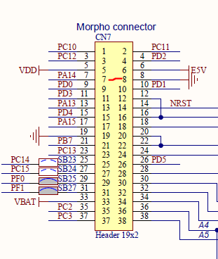

Hi Foued,
I shorted pin 7 and 8 in the image but still same error seen on the Cubeprogrammer. Is am I missing anything?
TIA
