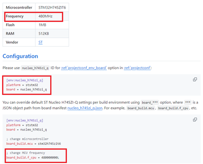

https://github.com/platformio/platformio-docs/blob/develop/boards/ststm32/nucleo_h745zi_q.rst
[env:nucleo_h745zi_q]
platform = ststm32
board = nucleo_h745zi_q

2024-09-06 11:07 AM - edited 2024-09-06 11:08 AM
Meanwhile, there is config problem. As I said, in SMPS System clock should not exceed 400MHz @VOS1:
I don't have an idea how PlatformIO works but you need to change the frequency to 400MHz and the voltage scale to VOS1
