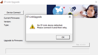

I also tried this firmware update utility but it cannot see the pod: https://www.st.com/en/development-tools/stsw-link007.html

@M_P wrote:I also tried this firmware update utility but it cannot see the pod:
It wouldn't: if the ST-Link is not appearing in the Device Manager, that means the PC can't see it at all - so no apps are going to be able to see it.
However, having got it working on a USB-C port, you might try the firmware update then.
The other thread found that disabling the MSC helped...
