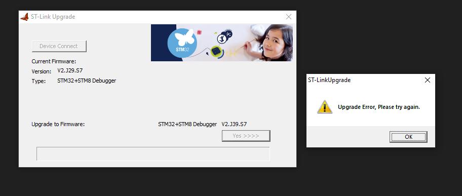

While I was working to upload firmware to a board STM32CubeIDE refused to upload code until i had updated ST Link from V2.J25.S7 to V2.J39.S7, while I wanted to comply I am getting the following error. Any help is appreciated.

Is the ST-LINK/V2 an original from STMicroelectronics or a clone?

Try a different cable, machine or port

I have changed cable & port still facing the same issue,

Do you happen to have a second ST-LINK/V2 to narrow down what/where the problem is?
