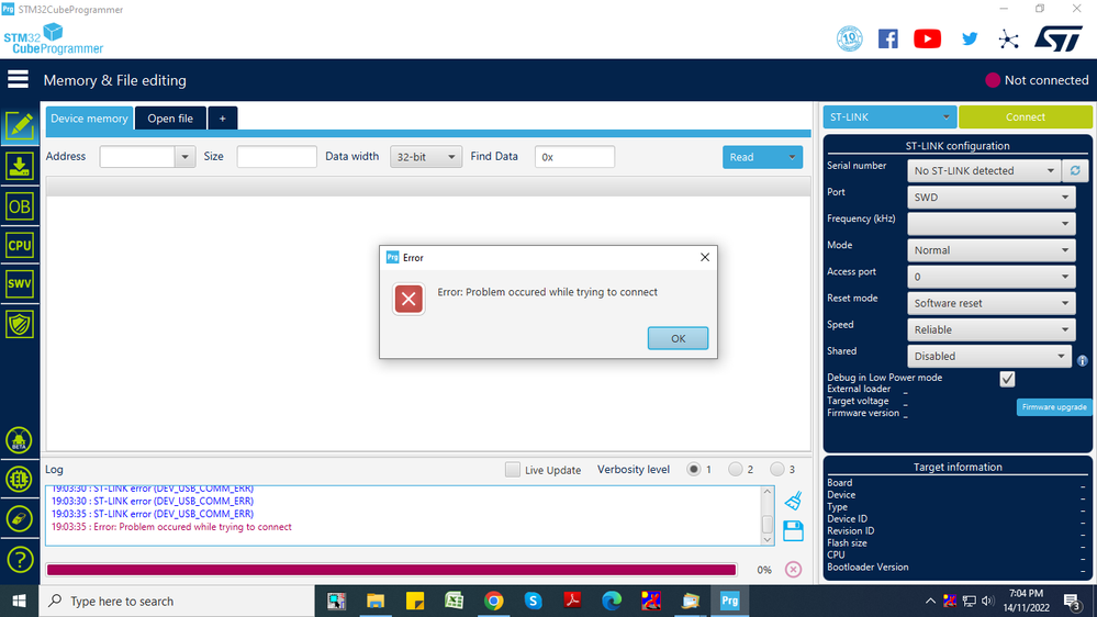

I have ST-LINK/V2 . its working with STM32 ST-LINK Utility V4.6.0
But whenever I using ST-LINK/V2 with STM32Cube Programmer V 2.8.0. ST-LINK/V2 not detect and not able to download program Even STM32cube Programmer can't recognized either ST-LINK/V2 connected or not.

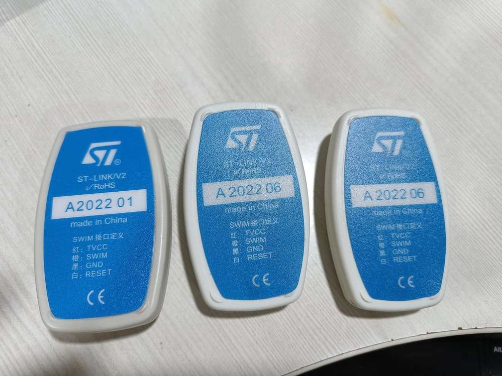

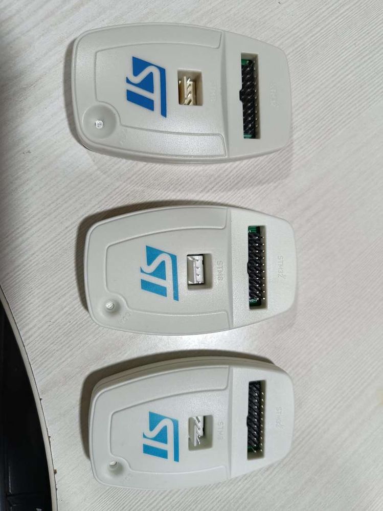

Could you please add a photo of your ST-LINK/V2 here, preferably with front and back?

Thank you, they look ok.
Can you please upgrade your STM32CubeProgrammer to the latest version and check again?

That's a very old version of STM32 Cube Programmer
You might also need contemporary firmware in the ST-LINK to operate properly with specific applications and versions thereof.
2022-11-14 5:35 AM
hello now using STM32Cube Programmer 2.11.0

Here it doesn't seem to see the device at all.
It shows up in Device Manager?
It has current drivers?
You have any AV or policy blocking USB MSC type devices, ie USB Flash sticks in a corporate laptop, etc.
Avoid USB hubs, or docking stations.
Avoid Virtual Machines, or check settings / sharing of USB resources.
Try different/better cables
Try different USB ports

From pictures, and because they are not working, there is a high chance those are clones.
