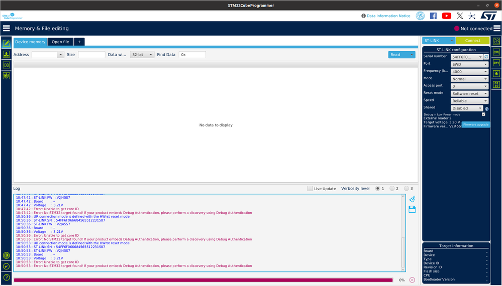

2025-06-09 9:51 PM
i have followed the stm32 stack overflow forum the 4th answer which mention to using the cubeprogrammer i have reduced the swd frequency lesser than 4000 khz. And now its also get connected in 4000 khz.

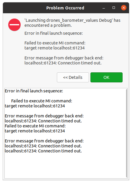

Additional to this there is an another dialog box arises when i debug or run the code.
what are the reasons this might get

Can you connect with STM32CubeProgrammer?

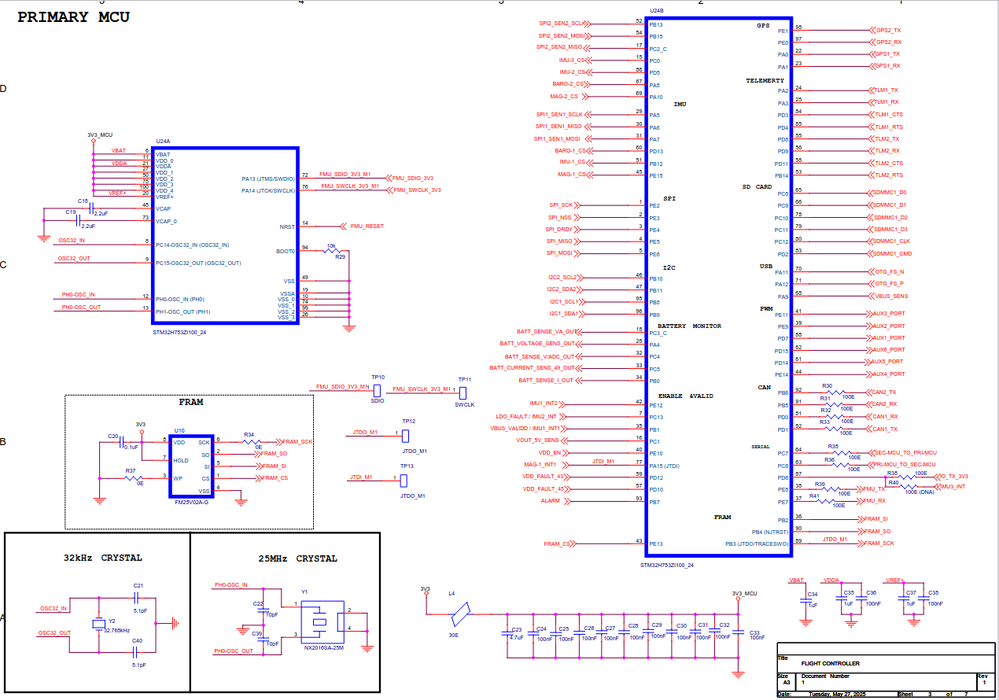

Can you show the board schematic? Could be a design issue.

2025-06-05 12:58 AM
No im unable to connect with stm32cubeprogrammer
i discuss with the hardware designer and send the design

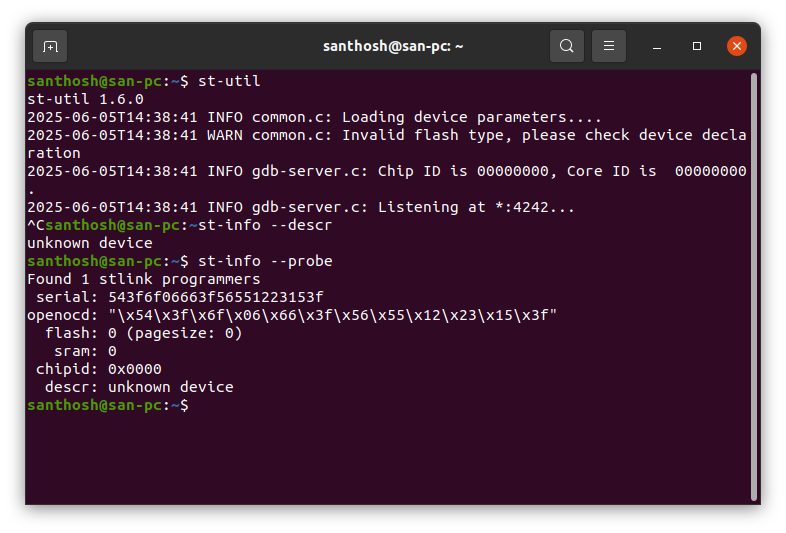

and now i connect it to through stlink commands in linux terminal. shows chip id and core id as 0.
is it due to its not recommended for new designs as they said in their website. https://www.st.com/en/development-tools/stsw-link004.html

yeah here the schematics

but im unable to connect with stm32cubeprogrammer
