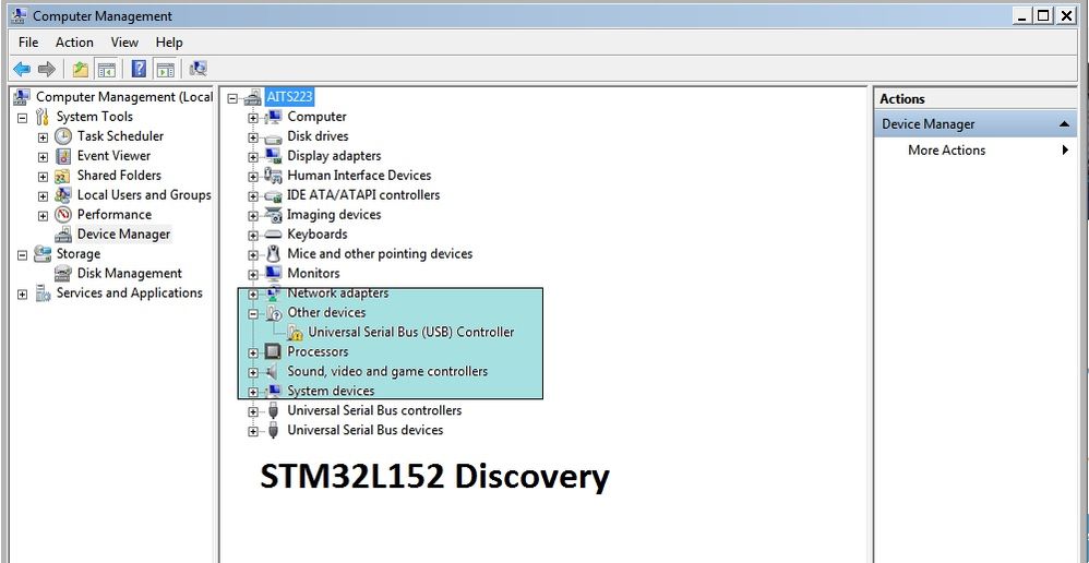

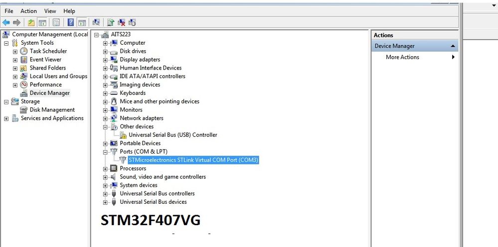

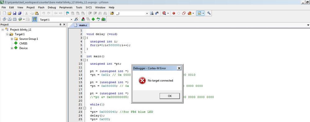

So why this issue in the STM32L1 discovery board.I also uploaded images regarding the problem in the board.

Ok, so try changing the connection settings to connect under reset, or try pulling BOOT0 high so your current code load doesn't run.
Then look at your code for low power modes or GPIO configuration that might break the debug interface.

ST link is detected but the code is not able to load in device and getting this error.

Perhaps the current application on the target (L152) "misbehaves", like going into sleep mode ?
Try booting the target into system mode, and do a Flash mass erase.
