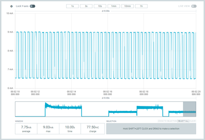

But a DMM really isn't a very useful tool - it can't show rapid variations.
It can't even show you the 100ms on/off of the LED in the standard demo code.
For that, you need some sort of proper power analyser - and then you do need to know which way around to connect it!

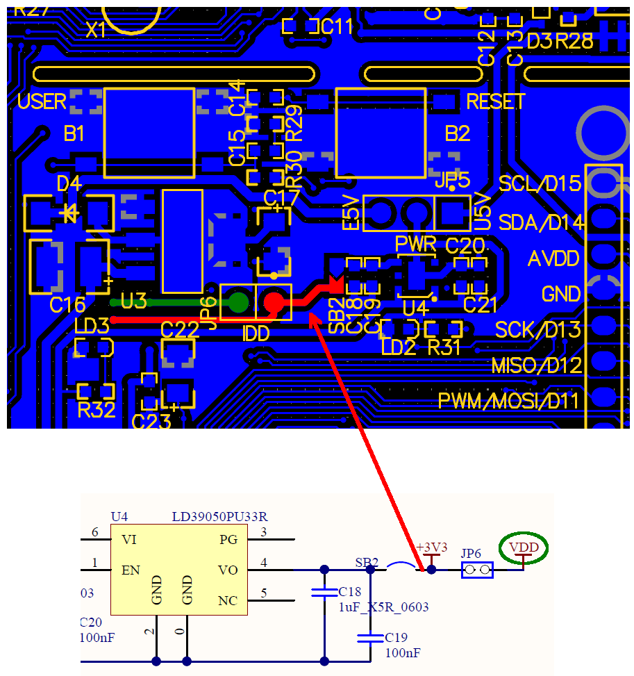

Well, if you want to operate the target without STS-LINK/V2-1 and only want to feed in there, this may play a role. However, according to schematics, the left pin of JP6 here is VDD, which can also be found on CN7.5.
However, the GERBER also shows the connections, e.g. as in the following picture, in which I have marked the tracks in colour:

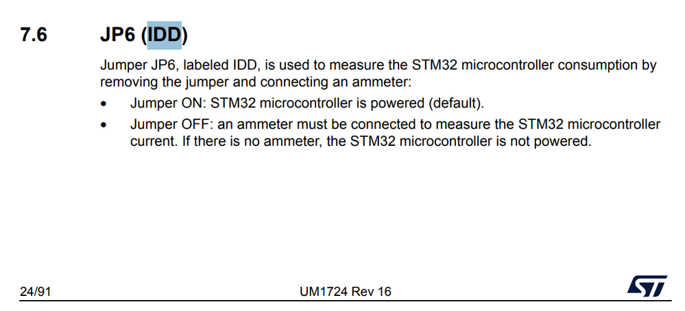

But @Andrew Neil surely means that this could also be in the UM1724.

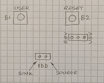

2025-06-09 8:59 AM
@Andrew Neil wrote:
From my standpoint this is something that could be indicated by silkscreen on the PCB.

Absolutely: I think it should be indicated - either on the silkscreen, or by the usual indication of "Pin 1" of the header by a square pad.
(as seen for JP5 in the image posted by @Peter BENSCH)
