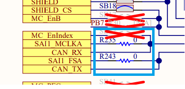

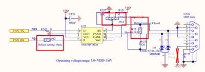

Hello @sonic_solutions and welcome to the ST community,
Attached a preliminary configuration of CAN1 on STM32L4R9I-EVAL board: PB8 and PB9 are used for CAN communication.
But from hardware standpoint, you need to ensure:
JP12 & JP13: fitted.
JP14 fitted in position 1-2:
Remove R235 and R243:
You need to connect another CAN node to the board that has a 120ohm terminating resistor connected on it.
Hope that helps.
