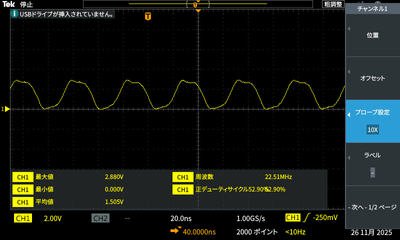

I set the pin speed to "Very High" for PF6.

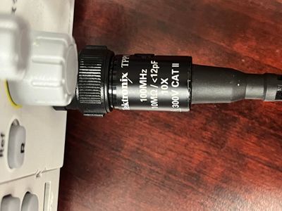

I am using a 10:1 probe as shown in Fig. 2.

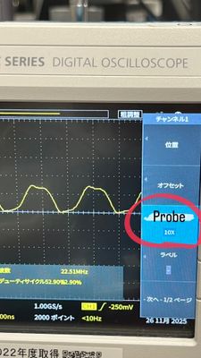

The probe is correctly set to 10:1, as in Fig. 3.

Fig.1 Wave of PF6
Fig.2 Probe
Fig.3 Probe setting

>the maximum voltage still does not reach 3.3 V.
Right, but thats fine now. Your probe loads > 12PF to the pin, at 22MHz this is about 800 ohms , so you cannot expect it better.
Try a high speed signal generator, if you have, and check its output at 20MHz, 0...3 V ;
to see, what your probe and scope can show at all here !
Because probe (and scope?) is 100MHz type, so looking at a 22MHz square, you can see 3. harmonic good, 5. harmonic is 22x5= 110 Mhz and will show still, but reduced level; and all higher harmonics your scope cannot show.
So all you can see from a perfect 22M square wave, is what you see now. (on 100M scope).
here 3. + 5. :

Thank you for the detailed explanation.
I understand now that the limited voltage swing is caused by the probe loading (over 12 pF),
which becomes roughly 800 Ω at 22 MHz.
So the reduced amplitude is expected and not an issue with the MCU pin itself.
Unfortunately, I don’t have a high-speed signal generator,
but I now see that with a 100 MHz scope, only the 3rd harmonic of a 22 MHz square wave is fully visible and the higher harmonics are suppressed.
Therefore, the waveform I am seeing is consistent with the scope and probe limitations.
Thank you again for the clarification.
