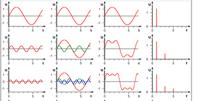

>the maximum voltage still does not reach 3.3 V.
Right, but thats fine now. Your probe loads > 12PF to the pin, at 22MHz this is about 800 ohms , so you cannot expect it better.
Try a high speed signal generator, if you have, and check its output at 20MHz, 0...3 V ;
to see, what your probe and scope can show at all here !
Because probe (and scope?) is 100MHz type, so looking at a 22MHz square, you can see 3. harmonic good, 5. harmonic is 22x5= 110 Mhz and will show still, but reduced level; and all higher harmonics your scope cannot show.
So all you can see from a perfect 22M square wave, is what you see now. (on 100M scope).
here 3. + 5. :

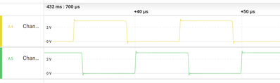

Pins are already in use, but it works fine here:
I suspect a measurement setup issue. Post pictures of your setup and show the scope plot of a significantly slowed down PWM, say 100 kHz.

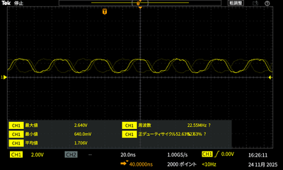

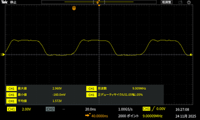

2025-11-23 11:43 PM
I used PF6 and I was able to output PWM.
However, the voltage did not reach 0–3.3 V.
When I lowered the frequency, the waveform became close to 0–3.3 V, but I need a 20–24 MHz clock.
Fig.1 PF6 PWM 22.5MHz
Fig.2 PF6 PWM 9MHz
2025-11-24 12:47 AM
PF6 seems to be free. + signal looks ok.
1. set pin speed high for PF6
2. use 10:1 low capacitance probe
3. set it to 10:1 .
