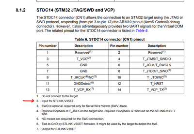

I would suggest to connect the VDD /T_Vcc pin as well, as it is used to sense of the target is powered :

AFAIK the ST-Link adapters don't require a T_Vcc detection. I converted basically all my ST-Links into J-Links.

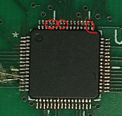

2025-12-01 6:42 AM - edited 2025-12-01 8:57 AM
Where are your bulk and decoupling capacitors? They should be next to the chip.
Could also be cold solder joints and/or bridges. Hard to tell in the photo.

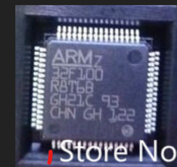

Marking on the top left of the chip looks like the mold injection mark, not the pin 1 marking, but I don't see a pin 1 marking elsewhere, or any text marking on the chip. Ensure orientation is correct. Pin 1 is bottom left when text reads from left to right.

2025-12-02 6:10 AM
Probably the wiring is incorrect, then.
Does STM32CubeProgrammer report the correct voltage?
Use a standard debugging header to avoid all of this.
