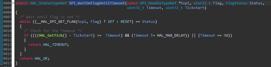

Starting a new project from the Board Selector works with no problem, however starting from the MCU Selector, the HAL_SPI_Transmit gets stuck at in stm32h7rsxx_hal_spi.c in the while loop at line 4008.

The issue appears to be that CubeMX is not setting things up correctly. It seems like extra setup is needed, but I dont see this info in the example documentation or anywhere. I hooked it up to a scope, but there is no clock produced. I believe the SPI_FLAG_EOT is the one that is not being set.

With no clock, makes sense that EOT isn't getting set.
