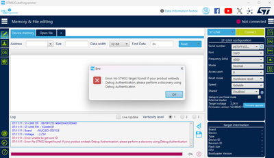

The LED is solid RED now. Here is the screenshoot of the Programmer:
2025-05-23 4:26 AM
I found the error. The jumper JP6 isn't connect. Thanks TDK for the help.
