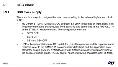

I have several NUCLEO-H755ZI-Q boards, the documentation says that the clock coming out from STLINK should be 25MHz but I meassured STLK_MCO and found an 8MHz signal... on SB72 to be more precise.
The sticker on the boards say
NUCLEO-H755ZI-Q
NUH755ZIQ$AT3
I was having issues when using HSE as a clock source, because I was configuring it to 25MHz as stated in the documentation and as it defaults to in CUBEMX... The issues went away when I set it to 8MHz.
Under the microscope X1 crystal shows 25.000.
Is there something to configure on STLINK to get the 25MHz?
Could the board be fake?

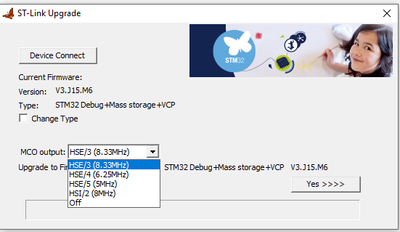

Hello @Gustavo_AR ,
Becarefull, the boards having STLINK V3, can generate different frequencies on STLINK MCO according to the mode selected using the STLINK firmware upgrade tool:
NUCLEO-H755ZI has STLINK V3 onboard.
By default it's HSE/3 = 8.33MHz and not 8MHz:
And you can change this according to the menu in STLINK firmware upgrade tool.
Need to update the user manual of the board (internal ticket 190627).

Thank you @Pavel A. My mistake was assuming that the frequency of the STLINK crystal oscillator went directly to the MCU. This assumption was reinforced by the fact that when starting a project on CubeMX for this board, the frequency for HSE is set to 25MHz. However, this should be the setting for the unpopulated X2 crystal.
Regards!

Hello @Gustavo_AR ,
2024-09-10 5:27 AM
Thank you @mƎALLEm. Mine was updated through VSCode STM32 extension. Now, by using the firmware upgrade tool I can see that MCO output is set to HSI/2 (8Mhz).
I consider that using 8.33MHz as a setting for HSE will incur in timing errors due to the decimals that are being left out. If precise timing is important I should better stick to HSE/4 or HSE/5 to have a precise time base tied to the crystal. I guess...
Thanks!!!

2025-02-11 12:49 AM
FYI: UM2408 / 7.9.1 OSC clock supply section has been updated:
"MCO from ST-LINK (default): The MCO output of ST-LINK is used as an input clock.
By default, it is fixed at 8 MHz and connected to the PF0/PH0-OSC_IN of the
STM32H7 series microcontroller. The frequency might be changed during an ST-LINK
firmware upgrade (refer to RN0093 for details)."
