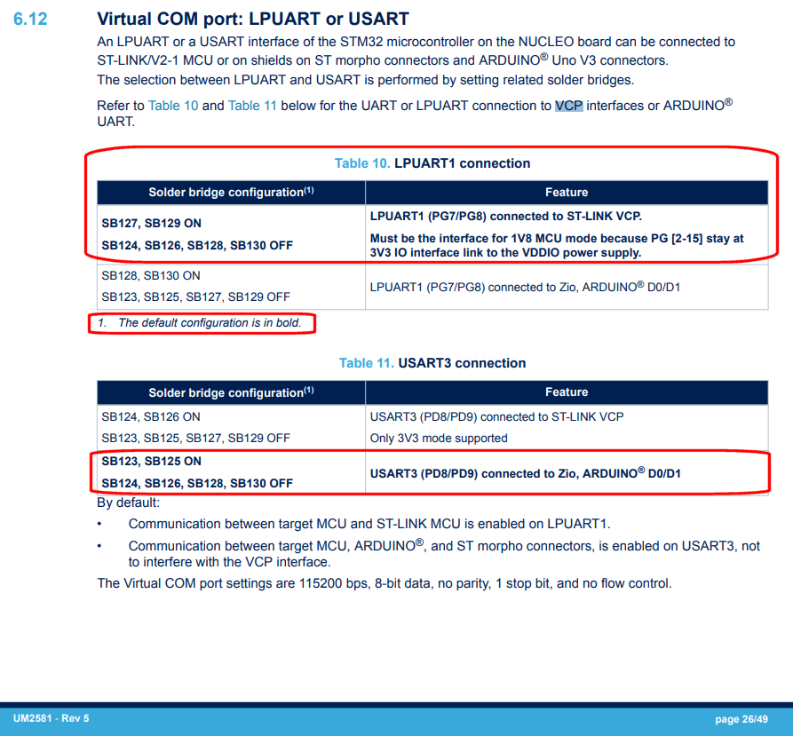

PS:
Note that, by default, USART3 is not connected to the ST-Link's Virtual COM Port:
2025-02-11 8:10 AM

2025-02-11 8:31 AM
Again, please see How to write your question to maximize your chances to find a solution - and note how to properly post source code.
@namuniu wrote:I need to configure the UART on my Nucleo board to cyclically send data through its virtual serial port.
Then you need to use LPUART1 - see the PS to my previous post.
