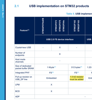

A pullup on DP is required on the STM32F103.
*Introduction to USB hardware and PCB guidelines using STM32 MCUs - Application note

2025-02-10 7:08 PM
