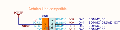

is there any way to use the pads pc8 and oc9 on the morpho header of tve nucleo h753zi? They are lebeled but dont receive signal. I see the signals on the according pins of the zio header.
right now I am thinking of drilling the morpho pads away and connecting through the hole patched from the zio header. I was hoping for a better way
thanks for helping

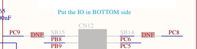

so, from : https://www.st.com/resource/en/schematic_pack/mb1364-h753zi-c01_schematic.pdf
...solder sb14 + 15. Then ...ok ?
2025-10-17 12:34 AM - edited 2025-10-17 12:39 AM
2025-10-17 12:58 AM
Perfect, that solved the problem. Thanks a lot :)
