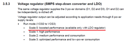

You are not allowed to exceed 400MHz with NUCLEO-H755 as the power is configured in SMPS mode in this board by default unless if you modified the hardware to be in LDO mode.
In SMPS you cannot exceed 400MHz at VOS1.
This is mentioned in the datasheet of the product: the boosted mode (VOS0) is available only with LDO power config:

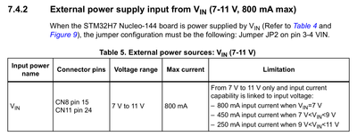

Nothing on the board will pull 1.3 A.
The user manual lists all the powering options. Max allowed is 800 mA through VIN.
USB connector is limited to 500 mA.
If you try to draw more, you will eventually either brown out or thermally limit somewhere.
2025-10-17 7:28 AM
That 800 mA maximum at 7V is to prevent the Vin linear low-dropout (LDO) regulator from generating too much heat and melting. From the schematic, if the 5V EXT input is used instead, that Vin regulator is bypassed. The separate 3.3V linear LDO from the 5V EXT is rated for 1300 mA max, but would likely need a much better heat sink to not melt. My question is: Can the MCU with all the circuitry on the full board actually draw more power than is available from the USB when everything is running and fully loaded? I've read in one of the App notes that the USB only requests 300mA of power when initializing. Has anyone actually used this NUCLEO board with numerous serial ports and counters running with a heavy software processing load and with the 100 Mb ethernet nearly saturated with UDP packets? I seem to have reliability problems at high processing load at 480 MHz, but it seems to work well when configured for 400 MHz max. Usually these type of problems are due to a power supply that cannot provide enough surge current when needed..

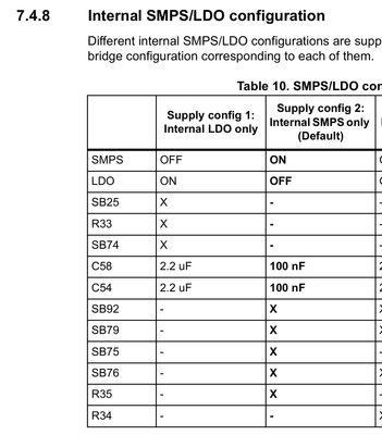

Also note that you can make modifications as given in the user manual to convert the board to use LDO.

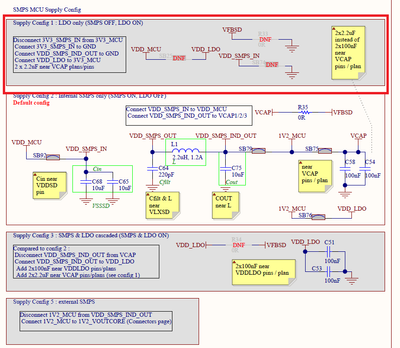

It's also indicated in the board's schematic:
