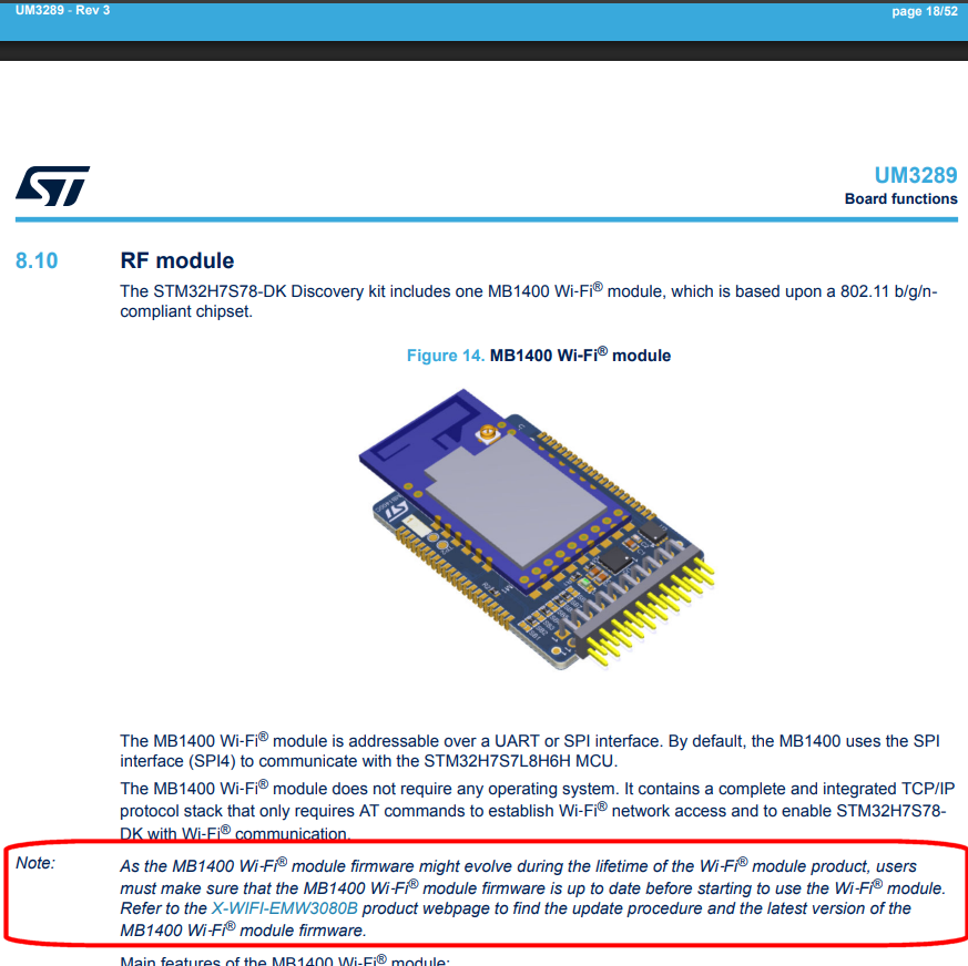

I am using the STM32H7S78-DK Discovery kit, which includes the MB1400 Wi-Fi module (as described in the UM3289 documentation).
I am developing with Keil µVision 5, and I would like to update the firmware of the MB1400 Wi-Fi module, but I cannot find any detailed procedure for doing this using the STM32H7S78-DK board.
Could you please clarify:
Where can I download the latest MB1400 (EMW3080B) firmware compatible with the STM32H7S78-DK?
What is the exact update procedure (UART or SPI interface, boot mode pin settings, required tools, etc.)?
Is there any example project or script showing how to perform the firmware update directly from the STM32H7S78-DK (similar to the approach used in AN5534 for other boards)?

Also, the UM3289 documentation mentions to refer to the X-WIFI-EMW3080B product web page for the latest firmware and update procedure, but there is no specific guide or driver available for the STM32H7S78-DK.
Could you please confirm whether an official update procedure or firmware file exists for this board?
Thank you for your help.

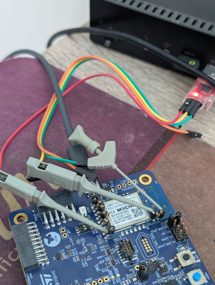

I spent a lot making 3080 go live on U585 on SPI2. I guess update is done by loading STM program with V2.3.4 software inside. I also was able to access console and probably it is possible to update right from there - I saw the commands in console. If someone is interested they can me free board and wifi and i will share all possible ways doing this job. I was working with STM support and found them pretty useless. Also I ordered couple original 3080 from Aliexpress for experiments.

2025-10-15 11:31 AM
2025-10-15 11:42 AM
There are couple of possible options. One is use USB to UART soldered to console and go through MXCHIP instructions but need to enter into bootloader of MXCHIP. (funny that MXCHIP used Realtec RTL Ameba board tools to do such operation). The other option is to open support ticket to STM, load firmware into macronix flash and write small program similar to what they have now that moves firmware to 3080 but not byte coded inside program but written in macronix flash that is present on your board. OR! change .ld for their program to use macronix as part of storage for data segment on macronics flash. You have all right to require support to provide you clear and easy option to do thus especially if you bought you board and wifi in pair from them. In addition I would add that making the wifi working is not piece of cake - I would love to hear your experience. and please send me the url of your support ticket and share this story with community. On my board Bluetooth is still silent but there is no place to solder probes :)
