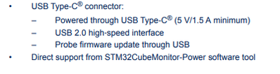

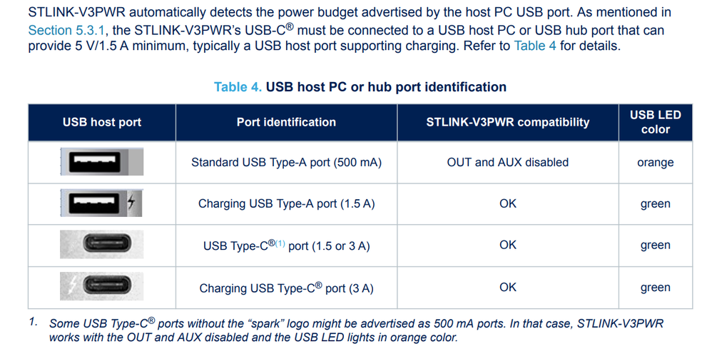

Ok, i see...
+ from manual, it should check , if connected usb port is ok...or not :
