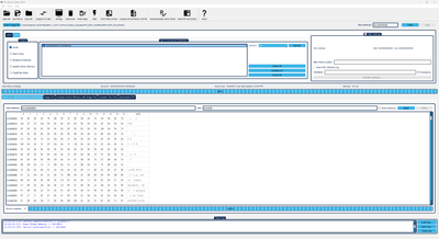

Hi Laurent,
I confirm that i use the ST\BlueNRG-1_2 DK 3.2.3\Firmware\BLE_Examples\DTM_M2SA_M2SP\BlueNRG-2\DTM_SPI_M2SP.bin
the flashing process success
Here a screenshot
However, I noticed that the input data register read by the microcontroller on the interrupt pin is always high. In the previous setup with the BlueNRG-2N, the signal was low and went high when an interrupt was triggered. In this current version using the BlueNRG-M2 module, the pin remains constantly high, so no interrupt is being detected.
Even after enabling the microcontroller’s internal pull-down or adding an external 10 kΩ pull-down resistor, the pin still never goes low.
Do you have any idea what could cause this behavior, and what would be the best things to check to diagnose the problem?
Thank you,
Sincerely.
