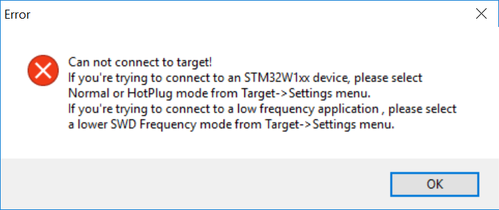

It didn't work from the beginning.
In the beginning I couldn't connect to the board at all, and if I tried, there were errors and I couldn't connect to the embedded st-link either. Right after disconnecting and reconnecting the USB cable I managed to connect to the embedded st-link and update the firmware. After that I could connect to the board too, but still, hitting a breakpoint causes loosing the connection. Also ST-link (application) thinks that the processor is F072RB when it's 070RB.
How about if I connected the SWDIO to CN7 pin 13 (PA13), SWCLK to CN7 pin 15 (PA14), NRST to CN7 pin 14 (RESET), VDD to CN7 pin 16 (+3.3V) and GND to CN7 pin 20 (GND)? Also jumpers from CN2 are removed.
2018-05-04 5:13 AM

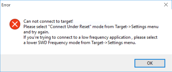

Aha, it does the same thing with ST-LINK/v2.

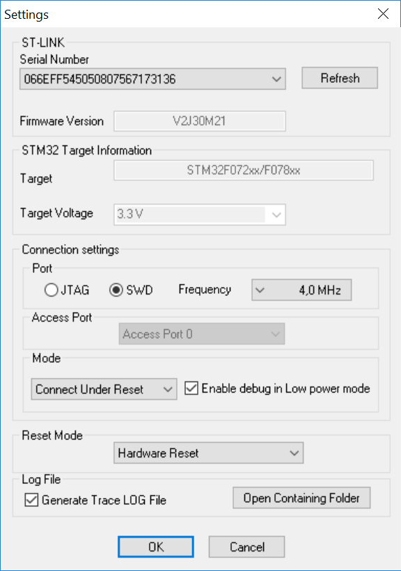

If I select the ''Connect Under Reset'' I get the second error pop-up.
2018-05-04 9:22 AM
This is how it looks with embedded debug interface (USB) with updated firmware.
