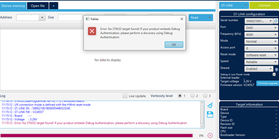

2024-10-19 2:25 AM - edited 2024-10-19 2:30 AM
Hi, so this is what I get.
There is one peculiar thing: When I switched on the power with the previous MCU (before desoldering it) the LEDs D3 and D5 lit up very dimly, leading me to believe the chip was faulty, the new chip also did it shortly but stopped after I disconnected it from power immediately. (Not a good sign either) A test with an older, less complex PCB design (different purpose board) also showed LEDs glowing dimly after some seconds but here the SWD is indeed working. So I'm asking myself again if the my new chip is faulty and if the problem is with the board design. Is it normal for some regular unprogrammed GPIO pins to go high after boot? One problem I could see is that 3V3 connection to the ST-LINK is straight through without a resistor and when I unplug the PCB the ST-LINK will feed the 3V3 to the board - might that have damaged something?

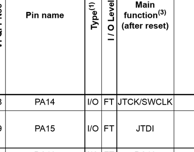

Yes. See pin functions at start/reset : you need sdw, jtag working, so these pins do something, pullup on, etc.
