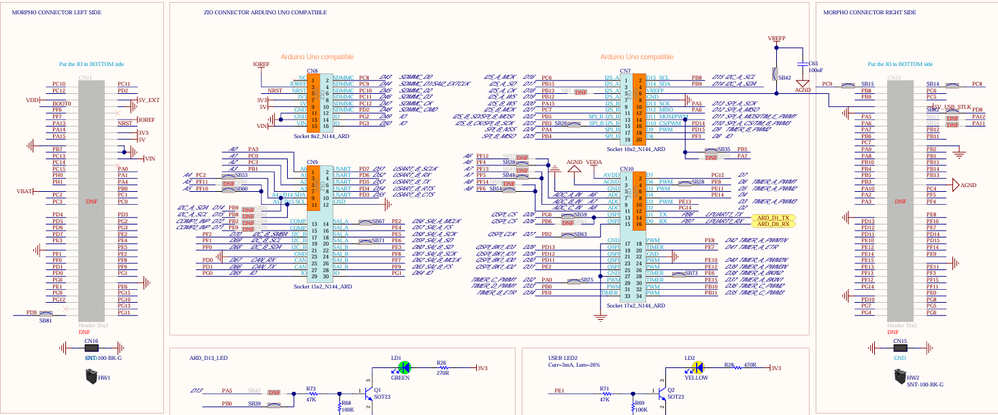

Gyessine
Hello @LysAn
Most of the ST morpho pins are also connected to Arduino® UNO R3 connector pins.
Check the product datasheet and schematics (ex: nucleo-H723 schematics MB1364) to determine if the peripheral you are using is linked to a pin that also has an Arduino pin, as these pins are more compatible with the type of wire you are using.
if not, you can consider @TDK and @Andrew Neil proposed solutions
BR
Gyessine

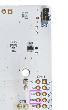

LysAn
Associate III
Thank you all for your suggestions. They pins I am looking for are specifically those for the external power supply. I am aware, that for the signal pins, the Arduino shield can be used. I wish the Arduino shield had a convenient access point for supplying the STM32 with power.
Best regards
You have the 3V3 and 5V pins on the Arduino headers.
Still unclear why soldering is unacceptable?
Yes, but the 3V3 and 5V pins on the Arduino headers are for powering external periphery, right? And I want to power the μCU via the external 5V. These pins on the CN11 are a bit clumsy to solder there, the tin somehow doesn't attach well there and the pins are almost touching each other. It is not so ergonomic. Untitled.png
Those are holes for standard 0.1" header pins. That's easily the best connector to use as they're the most common way to connect generic boards together.
If solder isn't sticking, use a flux pen. It gets easier with experience and better tools.
