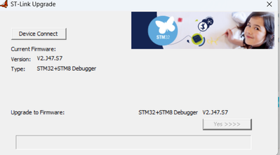

2026-03-21 11:16 PM
It can be detected by stsw-link007-v3-17-10
2026-03-22 5:38 AM

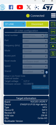

> flash the firmware successfully using STM32CubeProgrammer, but debugging through STM32CubeIDE fails with the error above
Sounds like you are using a counterfeit programmer and/or board. This is typical behavior. A genuine board will work.
2026-03-22 8:09 AM
Hi TDK, I trying to use ST-link from board nucleo but it still not work on IDE.
