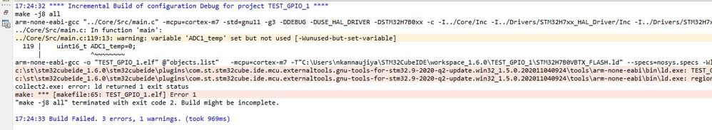

I am using STM32CubeIDE for my project . when i want to run the code i am getting this pop up.i am not able to solve this issue.

This is already a monstrously long thread, honestly got a NEW problem, start a NEW thread.
The 1.4MB is likely NOT contiguous, you're going to need to define the different spaces in the Linker Script (.LD) or related UI, and then direct content into the various RAM regions depending on appropriateness, either at an object/routine level or via the attribute directive.
