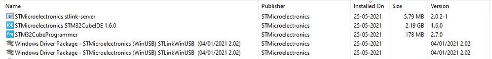

usb driver has been installed ,it is showing in control panel but not in device manager.
2021-05-25 6:08 AM
OK, fine with the STLink drivers.
