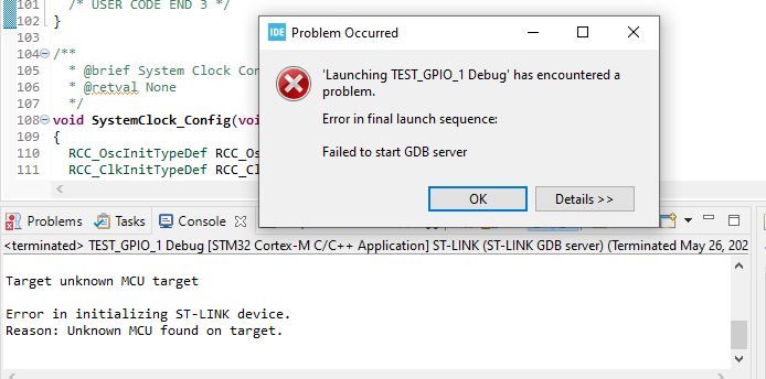

I am using STM32CubeIDE for my project . when i want to run the code i am getting this pop up.i am not able to solve this issue.

problem was the USB cable.
Now it is resolved.
Now new error is coming.

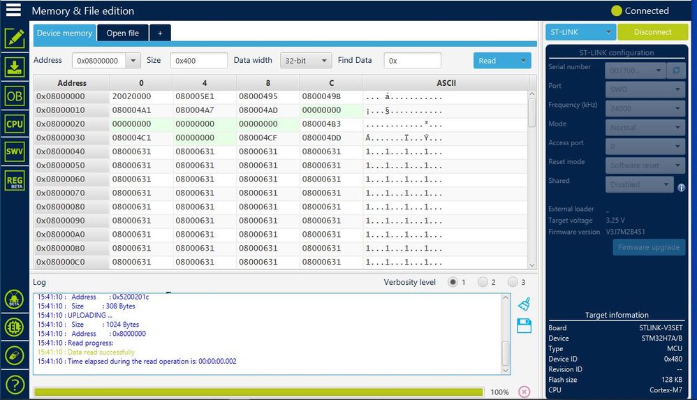

Q) Why can't you try in SWD mode ?
ans- yes ,its working, but after running it showing connection lost

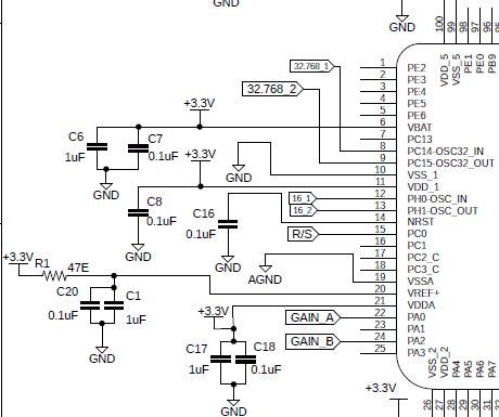

Q) Did you connect the STLink reset pin to NRST pin of device ?
ans- i think no, i have attached schematic(screenshot as well as pdf)

2021-05-26 3:35 AM
OK, you didn't connect the Reset pin.
If you can add the connection, it's better.
Then, without reset coming from STLink, you should avoid "Connect under reset" mode in debugger tab in debug config.
Like you did on STM32CubeProgrammer, use "Software Reset system".
Try to mass erase the device with STM32CubeProgrammer before debug.

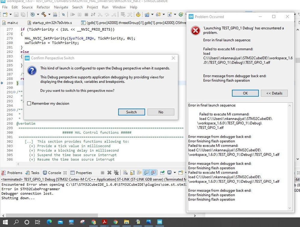

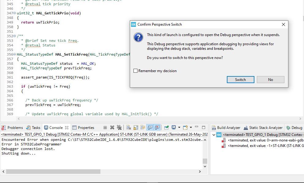

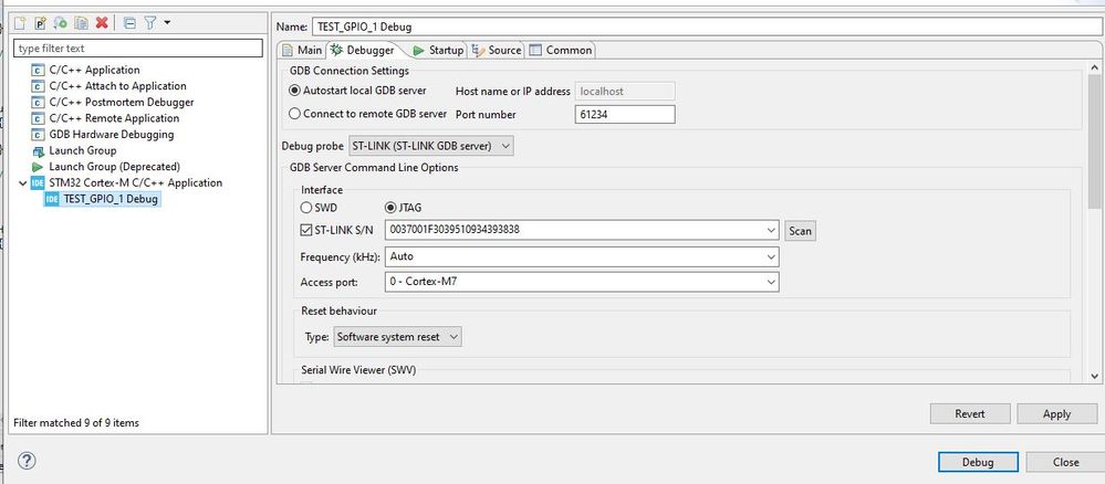

2021-05-26 4:18 AM
I selected "Software Reset system"and run with JTAG
it showing "connection lost" before running.

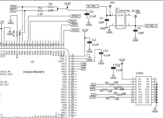

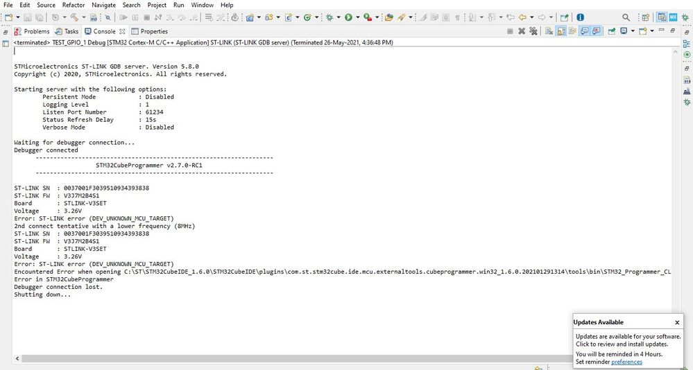

2021-05-26 4:26 AM
using JTAG i am getting this

is 22 ohm resistor(in JTAG connector in schematic) causing any problem?
2021-05-26 4:55 AM

2021-05-26 5:03 AM
I don't think the 22 ohm is a problem.
But you can lower the STLink freq (instead of "auto", choose 8 MHz or lower).
Can you try with Openocd.
In the debugger tab, choose Openocd debug server.
Then, click on "show generator options" to select the "Software system reset".
Maybe try also an empty project. Not a Cube project.
