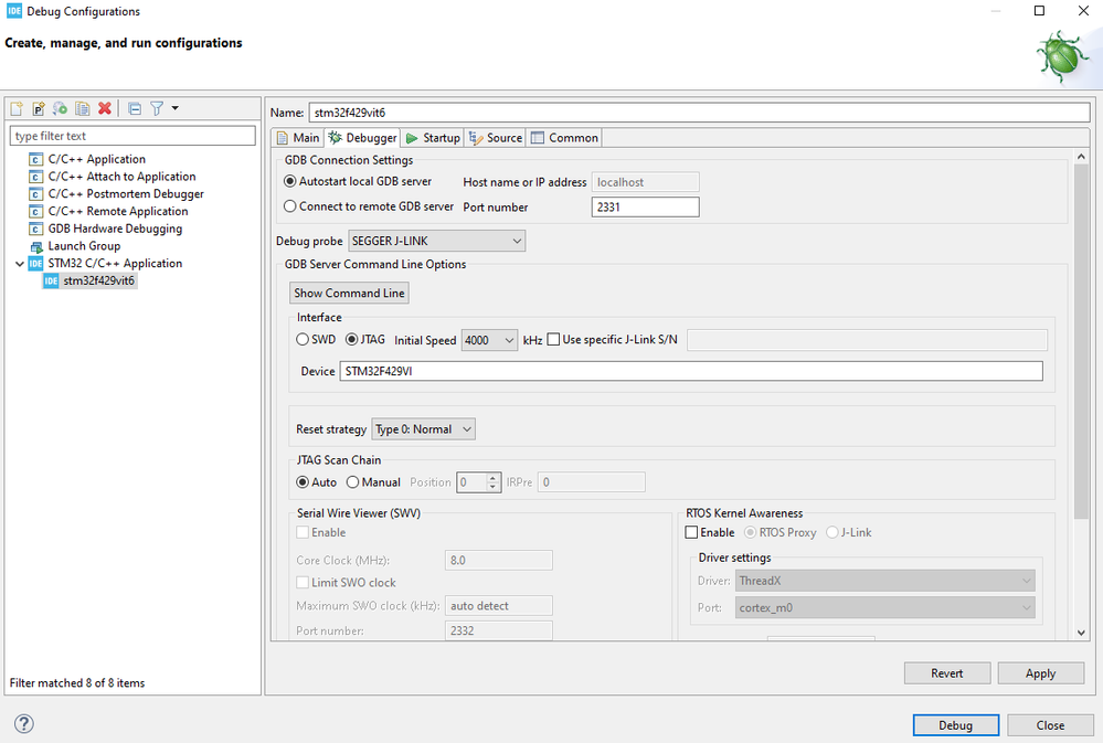

Hello, I am working on the project from scratch. I would like to know what are the minimum connections I will need for the STM32F429VIT6 in order to program? I have segger J-Link which I will be using. so far I have connect SWCLK (Pin 76), SWDIO (Pin 72), TDI (Pin 77), NJTRST (pin 90), and Vref 3.3V (Pin 75) and VSS (GND) (Pin 74). Is that the bare minimum connection I will need to connect the board and start programming? I did check the Datasheet, Ref manual and programming guide but I am not 100% sure. I am getting an error.

SWD requires SWDIO+SWCLK+GND. J-Link supports SWD, I'd try that.

+ in debug config. -> select SWD + "software system reset" ! ( <- for stlink )

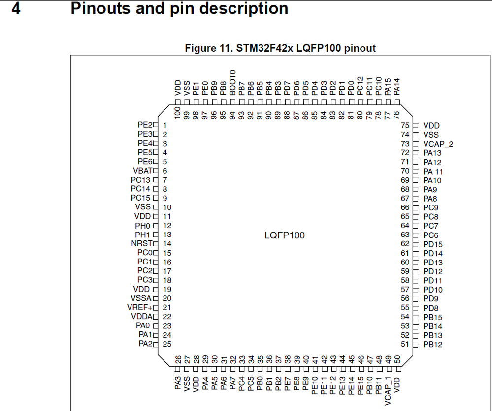

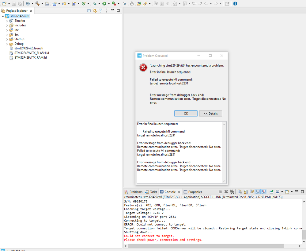

Hello TDK and AScha.3 I tried the SWD setting and connected SWDIO+SWCLK+GND but still no luck. can you please guide what are the minimum connections like VDD, VSS, Vcap1, Vcap2, etc?
Please see the attached pinouts. I am having a hunch that I am not biasing properly. Because the error message says "Could not connect to target. Please check power, connection and settings.".

There is no custom board it is pretty much like extension board for LQFP100 pinouts. pretty much like breadboard. Do I need to connect all the VDD and VSS of the board to +3.3V and GND? I want to know what are the minimum pinouts I have to connect in order to bias properly? I used 100nf caps for Vcap1 and Vcap2 and connected to the ground.
2022-12-09 12:23 PM
>like VDD, VSS, Vcap1, Vcap2, .. all of these, and correct cer.caps on vdd, vcapx .
i told you: ALL power pins !
boot0 to GND
, on RST a 10..100nf cap
see as reference : the circuit of a discovery board.

VCAP1 VCAP2 need bulk capacitance, so likely 2u2 each, or bonded together with one 4u7
