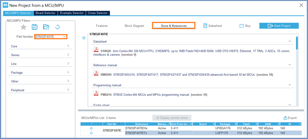

Actually, you can find in site all documents linked to the STM32F407IE.

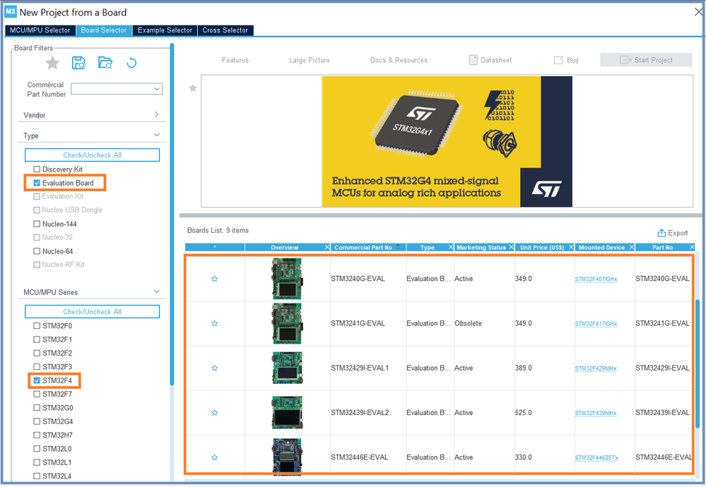

There's no F407IE Eval board, but if you're looking for an Eval Board based on F407 device, there's the STM3240G-Eval, I would take this opportunity to present you the Board Selector under CubeMX which can facilitate your search:
Hope my answer helped you, when your question is answered, please close this topic by choosing Select as Best. This will help other users find that answer faster.

In addition to the information provided by @Community member , I would like to share with you the link of the official CubeMX release.
You need to Start by creating a new CubeMX project, then you well get the page presented in my last comment.
All documents needed are available on st.com (Here for the case of F407IET) , and also on CubeMX:

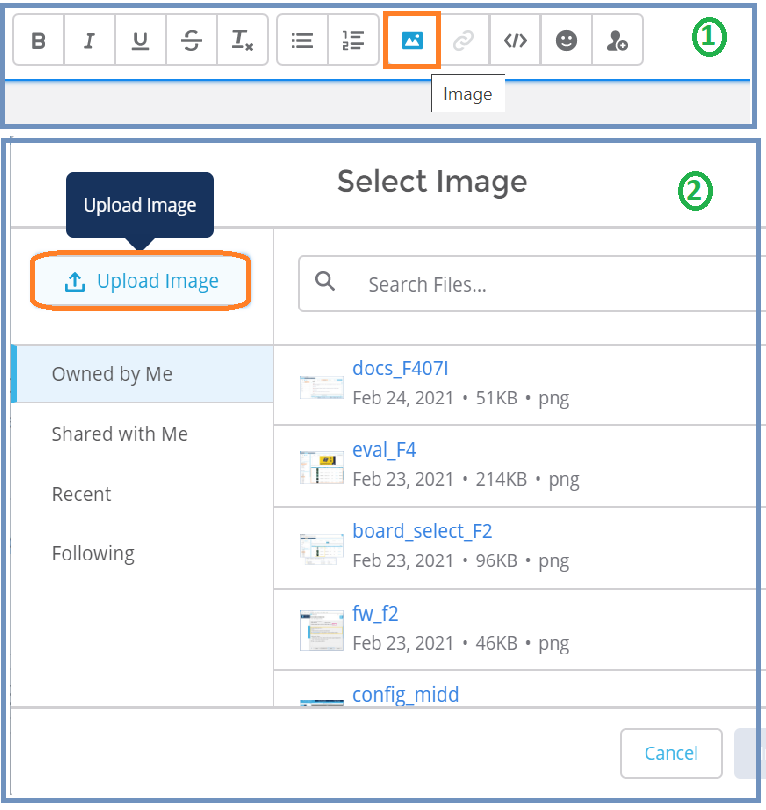

I cannot see the problem @KMusz.1 , Could you please attach (as mentioned in the image below) the image of your problem during the installation?
Thanks, Khouloud
