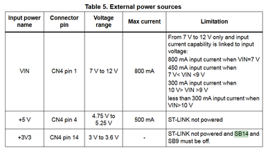

From the NUCLEO-L031K6 board documentation I found this table:
this shows that using a 5 v in will not run the ST Link, however reading further the following section is talked about:
The section doesn't include "running clocks", but I am not sure if the document would explicitly include "running clocks" since it might be an implicit understanding.

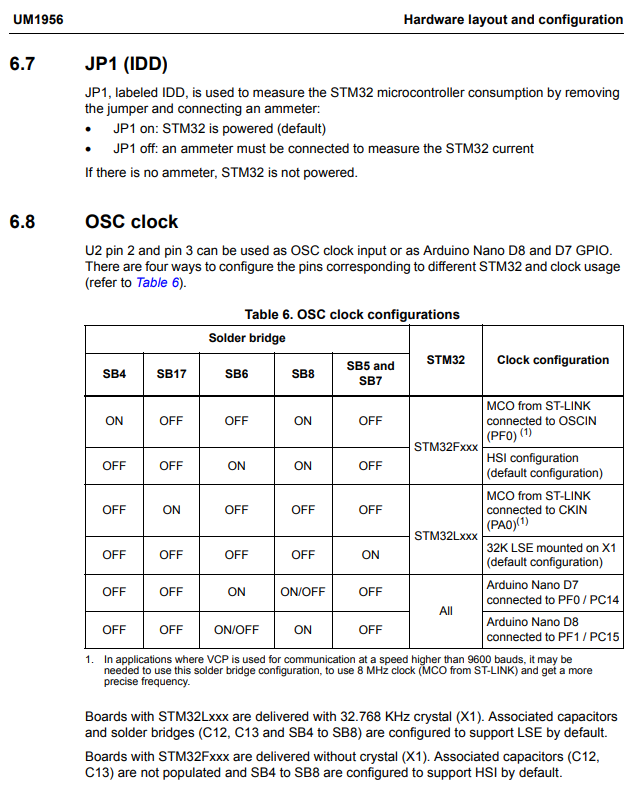

2024-04-16 9:26 AM
@genmastermega wrote:2. How am I able to check if the HSE clock is dependent on something else to be active?
As @Mike_ST said, look at the schematics for the board.
Also this in the User Manual:

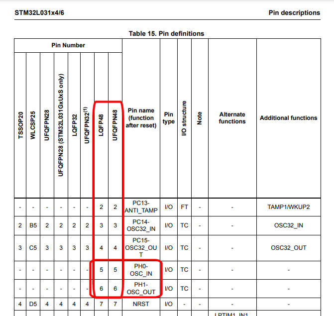

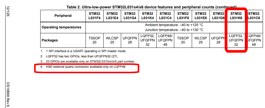

2024-04-16 10:06 AM - edited 2024-04-16 10:07 AM
@genmastermega wrote:NUCLEO-L031K6 board
The microcontroller on that is an STM32L031K6
From the datasheet:
So HSE is not available on that part.

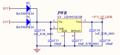

Looking at the schematics I have concluded that the ST-Link is only going to turn on when the Vin or USB power is given given the below image:
where E5V the power from VIN regulated down to 5 V and where U5V is the usb power provided which is inline with your comments about when the ST-link will turn on.

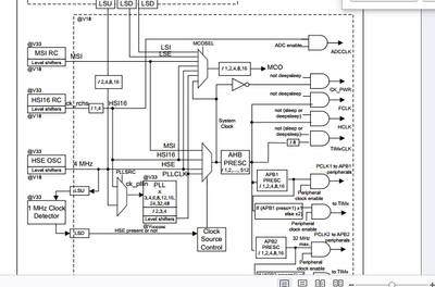

I understand that the ST-Link will not provide an MCO clock to the MCU but from the below section in the reference manual why would the MCU not work on another clock source such as the HSI?

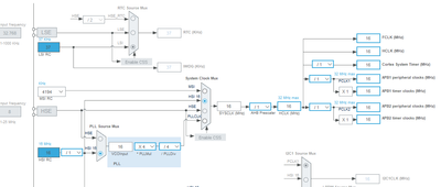

The below shows my clock configuration for my program:
Is there any issue with my clock configuration?

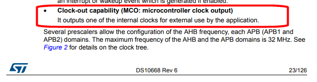

If you're uncertain if HSI is running, try routing the clock to MCO and viewing on a scope:
I don't see anything wrong with the clock configuration.
>> When I was running my system on 3.3 V external my code stopped working.
Please check table 5 of the user manual:
I would try to remove SB14 and SB9.
SB14 isolates the +3V3 from the connected regulators, and SB9 is the reset signal between the ST-LINK and the LSTM32L031.
