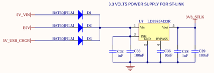

But sure, it's possible. Both the st-link chip and the target chip need powered, and the grounds need to be tied. Dig into the schematic for ways to tie 3V3_STLK to your 3.3V supply.

Yes, from a schematic standpoint I can see how to do it. However, I'd like to clarify the 3 voltage inputs to the ST-Link in the NUCLEO-stm32wL power tree. There is 3V3_STLK, 5V PWR, and 3V3 (my supply). If I leave 5V PWR disconnected by removing jumpers on JP4 and JP7, I believe 3V3_STLK would still be active as LDO U7 is hard-wired to the 5V usb input, so then why is it that the STLK is not active if as you said it just needs 3V3 STLK? Sorry if im being *** i just want to confirm so i can move on. I attached an image with some quick notes on the power tree. Thank you.

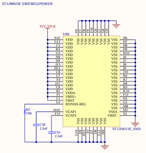

The "3V3" net does not power the st-link. It is powered from 3V3_STLK. Look at the schematic:

Associate III
Noted, isn't 3V3_STLK high though as soon as USB is plugged in? So should the STLK be available? Looking at this attached image.
TDK
Super User
Yes, 3V3_STLK will be powered if USB is connected (via 5V_USB_CHGR).

Okay, so, last question (hopefully).
if i follow this configuration:
1. Connect my own 3V3 supply on CN6 pin 4
2. Remove jumpers on JP4 and JP7 to disconnect the "5V_PWR" from ST-Link
2. Connect USB power and U7 LDO regulates the 3V3_STLK to high.
4. Will this result in me being able to separately power the STM32WL MCU and still be able to have USB plugged in to keep ST-Link on and read/debug fw logs?
