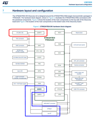

2024-04-19 3:48 AM - edited 2024-04-19 3:58 AM
@User1340 wrote:I am using option in the console Command Shell Console and it is configured just as settings of the USART2 (port, baud rate, data bits, stop bits and parity) and it could be used for any usart probably..
Yes, it can be used for any USART - but how have you physically connected USART2 from your target system to this Command Shell Console on your computer?
@User1340 wrote:To be clear, I have disabled USART1 and only enabled USART2 to communicate...
That doesn't clarify anything at all.
Enabling USART2 to communicate will not provide any connection from that USART to the PC.
How do you make the physical connection from USART2 to the PC?
EDIT:
As you can see from the User Manual, USART1 is connected to the ST-Link (Red), but USART2 is not (Blue):
So you're going to need to make some other arrangement to get the signals from USART2 to the PC ...
2024-04-19 8:20 AM
Ok, but how that's supposed to magically connect?
To get data out of the ST-LINK's VCP you're going to have to enable both USART1 and USART2, and then in the crudest implementation, sit in a loop checking the receive status of each, and moving data from one to the other
while(1) // Pseudo code, probably also want to tackle noise, overrun, framing errors
if (USART2->ISR & USART_ISR_RXNE)
USART1->TDR = USART2->RDR;
if (USART1->ISR & USART_ISR_RXNE)
USART2->TDR = USART1->RDR;
