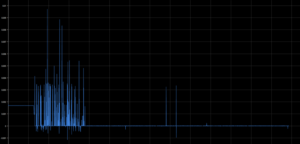

Using this example, I measured the current consumption following the method described in the first post. According to the datasheet, this method powers only the MCU, meaning that all additional hardware on the development kit (such as LEDs, ST-Link, etc.) is disabled. I configured the low-power mode to the maximum level (level 2, i.e., standby) and disabled debug/logging features to minimize consumption.
I have attached a photo of the results. During the fast advertising phase, there are visible current peaks. When the system transitions to low-power advertising, the current drops to around 15 µA, which is very close to the datasheet specification for BLE advertising in standby mode. However, even in this mode I get random peaks, what are they?

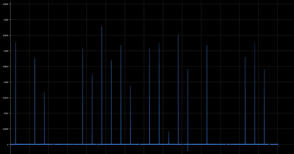

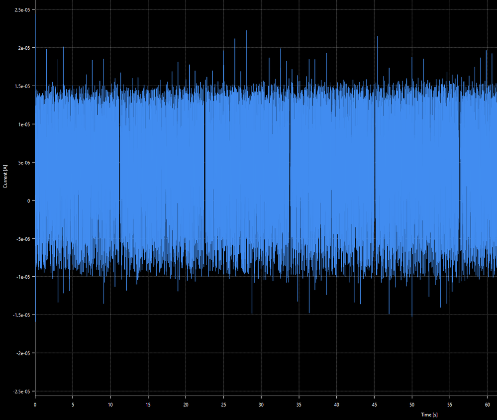

Based on this example, I developed my own application following the same principles. However, in my case, I use low-power advertising continuously. Therefore, I expected to observe a relatively constant current around 15 µA, without significant peaks.
However, as shown in the attached images, there are multiple current spikes that I do not fully understand. Could these spikes correspond to BLE packet transmissions? Some of them seem to be separated by 2.5 second what would make sense, but this beahviour is not constant. If so, why does this not happen in the original example?

Hello, quick update, I have removed the line that starts the advertise from my code and the mean consumption should be around 7uA. So I'm guessing the spikes are related to the BLE advertise.
