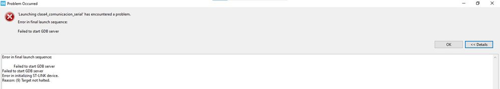

I have a development board with a STM32F401CCU6 MCU. Until now, I had been doing exercises without problems in stm32cubeide. The problem was when I wanted to do an exercise with USART and show the result with the Realterm software, the program compiled correctly and allowed me to debug it without errors with ST-LINK, on the other hand realterm did not show me anything, so I tried to reset the MCU pressing the button, also still had no results, I made sure that the configuration in realterm is ok. Then I tried debugging it again and there it gave me the following error:
STMicroelectronics ST-LINK GDB server. Version 6.0.0
Copyright (c) 2021, STMicroelectronics. All rights reserved.
Starting server with the following options:
Persistent Mode : Disabled
Logging Level : 1
Listen Port Number : 61234
Status Refresh Delay : 15s
Verbose Mode : Disabled
SWD Debug : Enabled
InitWhile : Enabled
Target not halted after reset.
Target not halted
Error in initializing ST-LINK device.
Reason: Target not halted.

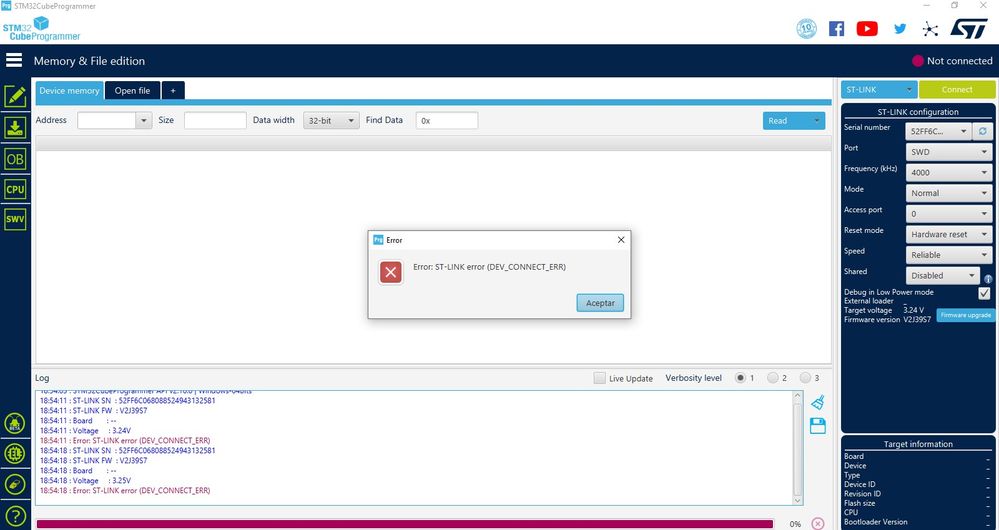

STM32CubeProgrammer v2.9.0-RC01
ST-LINK SN : 52FF6C068088524943132581
ST-LINK FW : V2J39S7
Board : --
Voltage : 3.25V
Error: ST-LINK error (DEV_CONNECT_ERR)
Encountered Error when opening I:\ST\STM32CubeIDE_1.8.0\STM32CubeIDE\plugins\com.st.stm32cube.ide.mcu.externaltools.cubeprogrammer.win32_2.0.100.202110141430\tools\bin\STM32_Programmer_CLI.exe
Error in STM32CubeProgrammer
Shutting down...
Exit.

Is this a Black Pill / Blue Pill type board, please be specific, with links to board, and info on exactly what is connected, and to what.
Does STM32 Cube Programmer work, does it find/connect with the board successfully.
If you need BOOT0=HIGH to connect, consider doing an ERASE on the part, and dwell on what you're doing in the code that would cause it to block other access.
Assume we have very little context about what you're doing, or what code you're compiling
2022-05-27 11:07 AM
-Is a black pill board
-STM32 Cube Programmer work, i checked it with a blue pill i have.On the other hand with the black pill, it doesn't find/connect with the board properly

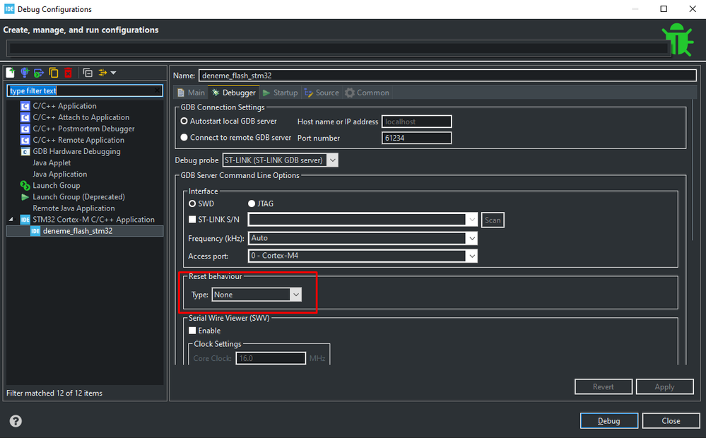

hello, good news... i was able to solve the problem.Pressing Boot0+NRST and then debugging with that configuration.
But I do not understand the cause of the error, if someone explains to me that I do not understand much, Why do we have to select none?
