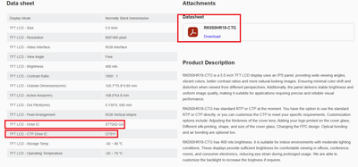

From the architecture of the product, you can find the LCD is linked to the board MB1860.
Then in the MB1860 board design source, you can find the MPN of this LCD is "RK050HR18-CTG".
Then search "RK050HR18-CTG" in google, you can find the information related:
LCD driver IC: ST7262-G4
TP driver IC: GT911
TP driver IC: GT911
