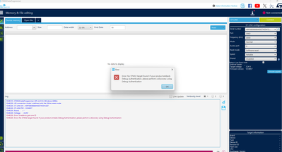

4. Please check the screen capture as below. Target board voltage is pretty low as 0.23 (Probably shall be around 3.3v).
USB C is not enough external power?
2026-02-19 9:11 AM
0.23 V is not enough voltage for the device to run.
How is the device powered? The programmer does not provide power. The VCC pin is an input to the programmer.

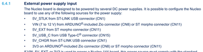

There are a number of ways to power the board. You need to have one of those present. See the user manual for details. CN15 should work.

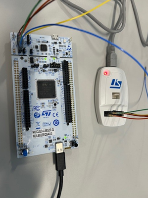

pin #1 on CN5 is connected to pin #1 on 20 pin connector of ST Link v2. L552E-Q board is powered from USB C (CN13). Board connection with ST link v2 is captured as below.

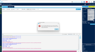

After CN5 pin1 is connected to 3.3V on CN8, target voltage is 3.24v. However, still NO STM32 target found.
