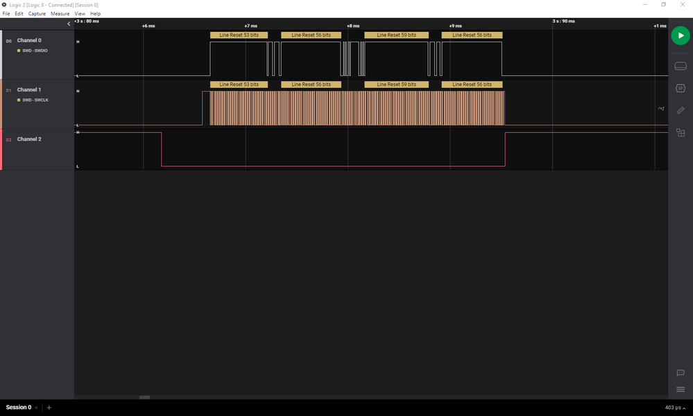

As for NRST, I checked it with a logic analyzer and got this back. It looks like its working to me, at least in terms of the NRST line.I'll see what else I can find.

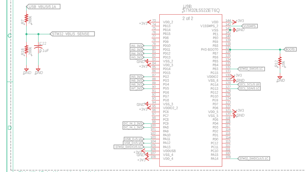

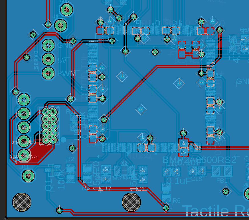

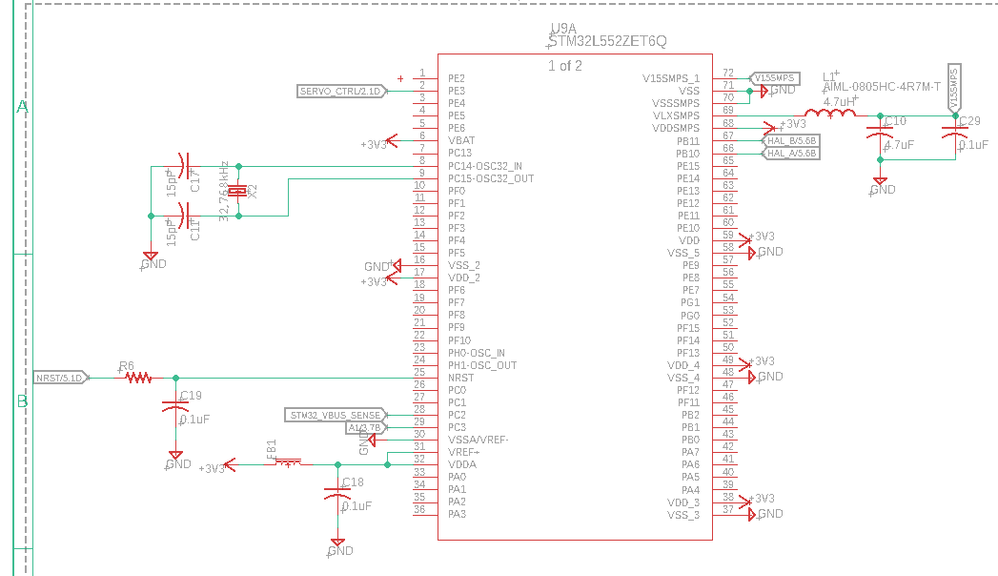

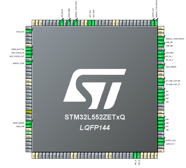

No, it's not getting finger-burning hot. As for the layout, here's the layout regarding the microcontroller (Board and schematic) as well as the MX layout.
2022-09-21 7:52 AM

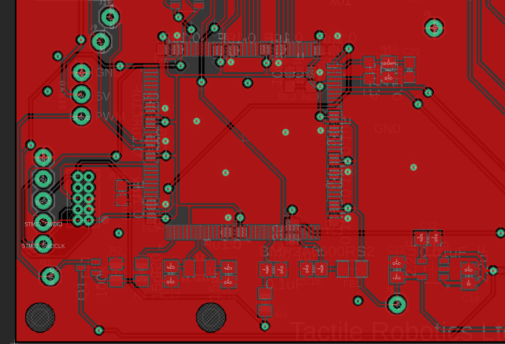

I realize that the brd file image is a bit much and I'll get a better one. In the meantime, the bottom-left corner is pin 1, then it continues right.
2022-09-21 10:22 AM
Can you get a picture of the PCB section with the part on it?
Schematic looks reasonable enough, SWD traces look Ok.
