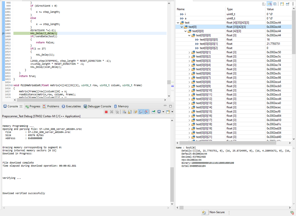

This image is of the array values as they should be, and are when outside the sendData and sendMatrix functions.

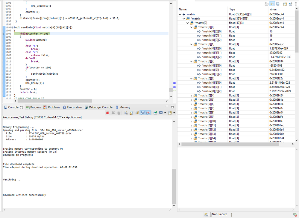

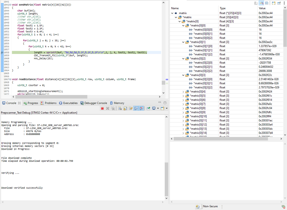

And this image is what arrives inside the sendData/sendMatrix functions:

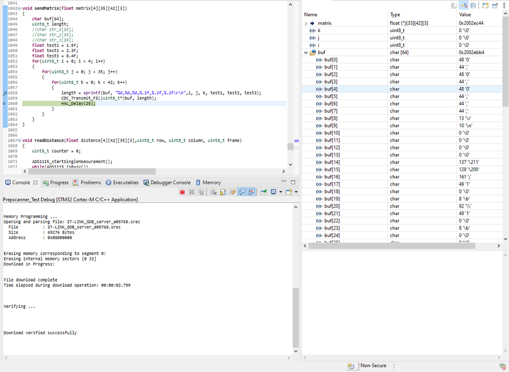

Additionally, I cannot get sprintf to format a string with ANY float values, as shown in the below screenshot

Found the final problem. At some point, I'd accidentally changed configuration from debug to release, and did so before enabling the sprintf float option. So, whenever I fired up debug, I couldn't send any float information. I switched back to debug, re-enabled the float sprintf option, and everything is working

Some of the debug screens seem to should addresses of pointers
Check that the sizeof() for the array matches expectations of size vs dimensions.

That said, I am confused why the debug screens would be showing the addresses of pointers, since they don't do anything like that in other functions where I pass the same array in to set the values; It's all zeroes there. The main difference is that I'm setting the values in the one function, and putting those values into a string in the other, but I'm lost on why that would change the appearance of the array when I enter the other function.
