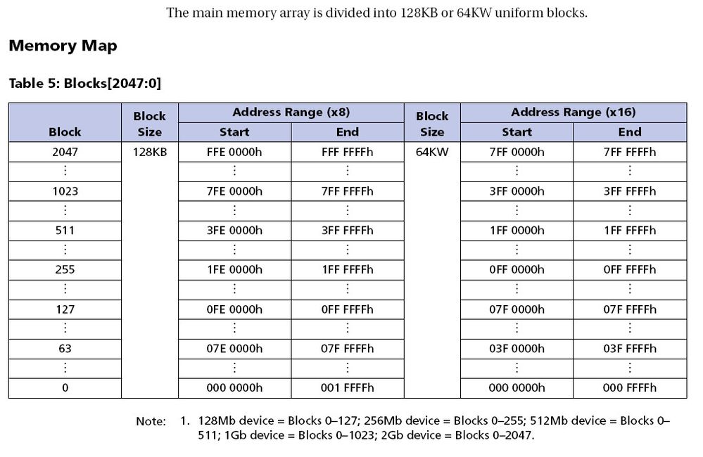

OK, I believe I found the cause of Hard Fault. I made a small function to test bus operations (read/write/erase) on the NOR flash. The program crashes as soon as the access exceeds the 511 block. The device I'm working on has 1024 uniform blocks. Here's the memory map of the M29EW NOR Flash:
Any attempt to read/write the bus beyond 0x1FFFFFF causes a Hard Fault. Block 512 @ 0x2000000 in device memory map, which is 0x62000000 in the STM32 device space. Although this is still within the safe boundaries of the first sub-bank of NOR/PSRAM (NE1), the program crashes.
To sum it up, the following problem posted by "connect" seems very similar to mine: https://community.st.com/s/question/0D50X00009XkiC7SAJ/stm32f417igt6-fsmc-a25-hardfault
According to Clive, in the 16-bit space, it's not possible to have A[25..0]. Well, could someone elaborate more on this for me?
Thank you again,
Zaher
