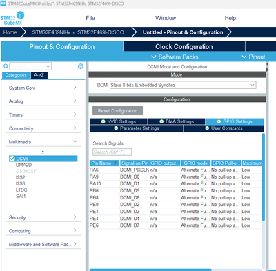

I'm trying to interface a DVP camera (like OV5640) with the STM32F469I-DISC0 board using the DCMI peripheral in 8-bit parallel mode.
What I have:
- The camera is configured and outputs data correctly via I2C.
- I'm using bare-metal code (no HAL or CubeMX), and SDRAM + USART debug are working.
- DCMI pins are being mapped as per the STM32F469 reference manual.
- I verified that I can access and remap the following DCMI pins:
- D0 – available
- D1 – available
- D2 – available
- D3 – available
- D4 – not available(e.g., PE5)
- D5 – available
- D6 – available
- D7 – available
- HSYNC, VSYNC, PCLK – available
Problem:
- DCMI_D4 is not brought out on any connector** on the DISC0 board. It's internally routed to LCD or unused.
- I checked the board schematic and there’s no easy way to solder to it either.
My questions:
1. Can DCMI work with 7-bit data (skipping D4)? Will DCMI capture still be valid if D4 always reads 0?
2. Is there any known workaround for the missing D4 line (e.g., using a dummy input, or masking D4 at software level)?
3. Has anyone successfully interfaced a camera with this DISC0 board and ignored one DCMI data line?
4. Would you recommend switching to 4-bit mode or dropping down to RGB444 or YUV422 and masking bits?
Additional context:
- My goal is to capture camera frames in RGB565 or YUV format and display/stream/debug from SDRAM.
- I’m okay to accept reduced image quality if 1 bit is lost (e.g., D4 = 0 always), but want to understand if DCMI handles this gracefully or fails.
Thanks in advance for any insights or prior experiences!

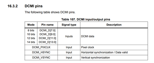

Hello @sanjaykrishnegowda and welcome to the community;
According to reference manual the DCMI main features are:
• 8-, 10-, 12- or 14-bit parallel interface
• Embedded/external line and frame synchronization
• Continuous or snapshot mode
• Crop feature
• Supports the following data formats:
– 8/10/12/14-bit progressive video: either monochrome or raw Bayer
– YCbCr 4:2:2 progressive video
– RGB 565 progressive video
– Compressed data: JPEG
7 bits mode is not supported.
Note that the DCMI_D4 is available on PE4, PC11 and PH14 pins.
Thanks and best regards,
Kaouthar

Edit : I soldered the SDCard pin and have been using that for DCMI . Looks like that is the only way.
