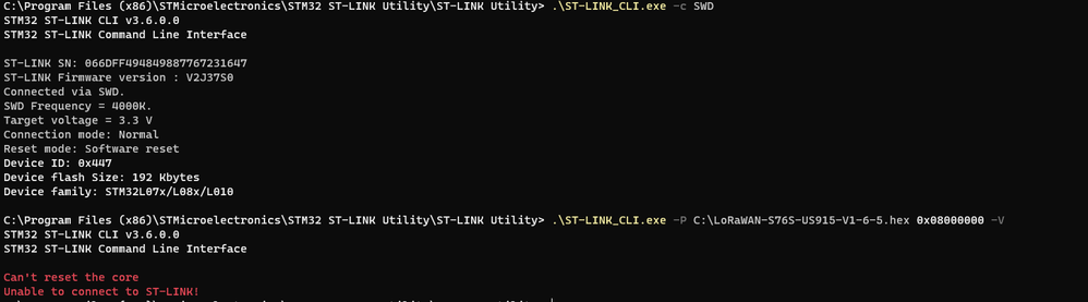

(On Nucleo L073RZ devkit with target on SWD) I can easily connect and program a hex file from the stm32 link utility UI but it seems impossible from the CLI. Connection parameters are the same (Mode: Normal, Reset Mode: Software system reset) and the
.\ST-LINK_CLI.exe -c SWDcommand works fine, but not
.\ST-LINK_CLI.exe -P C:\LoRaWAN-S76S-US915-V1-6-5.hex 0x08000000 -VBoth outputs are in the following picture.
2022-07-26 9:43 AM
UPDATE:
Altough I didn't quite see such infoin the CLI documentation, I've found out that the connection command only connects to the target for the duration of the command and close the connection after, making it impossible for the program command to work.
FIX:
Just 'pipe' the 2 commands and it should work perfectly:
.\ST-LINK_CLI.exe -c SWD -P C:\LoRaWAN-S76S-US915-V1-6-5.hex 0x08000000 -V
