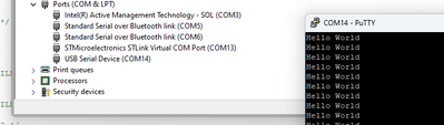

Hello @medyassinetouati
I tried to replicate the issue, but I couldn't reproduce it
I attached the whole project as a zip file
run the project and check device manager for your VCP number and visualize the result using your favorite serial monitor tool (example: putty, teraterm ...)
