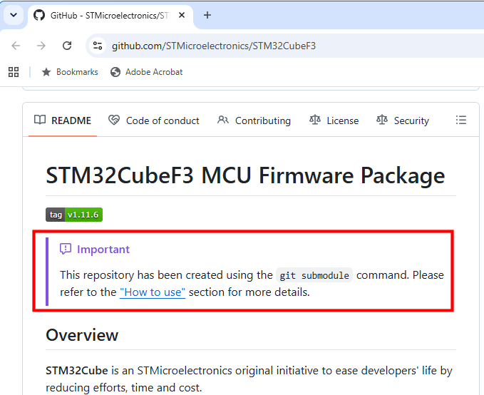

Saket_Om
Hello @Adriano Melis
Please refer to the article below to learn how to download STM32Cube package from github.
Downloading STM32Cube packages from GitHub correct... - STMicroelectronics Community
Saket_Om
mƎALLEm
I suppose you cloned the github link without the recursive option.
Please refer to this article: Downloading STM32Cube packages from GitHub correctly

Hi Adriano,
it is sure to miss some files if you clone it or download zip directly from the github, please use command 'git clone --recursive https://github.com/STMicroelectronics/STM32CubeF3.git' to clone it, you will get the complete project which can work well.
